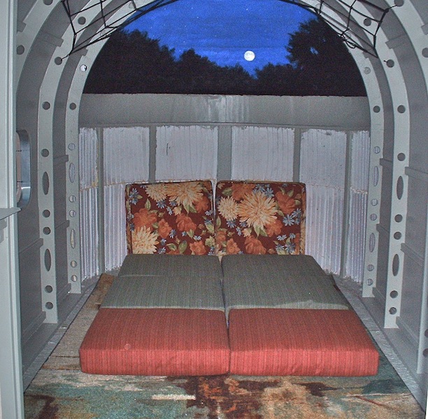

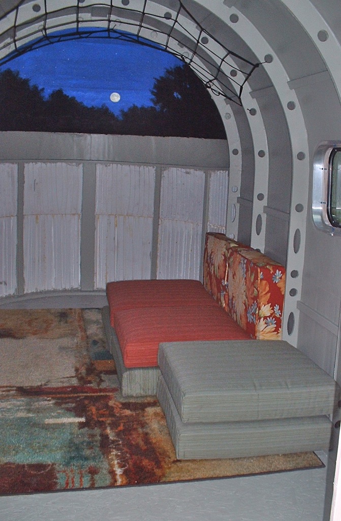

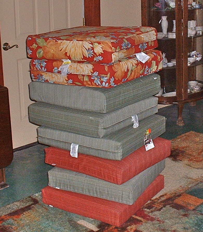

Postby GPW » Sat Nov 17, 2018 5:38 am
We got a bunch of outdoor cushions on clearance at Wal Mart , and they can be arranged any way you want , no heavy frame required …

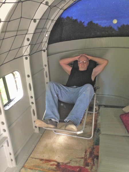

I see where you are coming from John, I really do. Making that frame is easier for me than making a vinyl covered mattress pad plus I want the mattress thicker than a pad. When I use the camper alone I have used a Thermorest mattress and that gives me room. I whipped up a beach type chair that fits well inside and is comfy. The futon mattress that my wife and I use is much better than a Thermorest. There is no room for chairs, of course. As of this moment the idea for a "Craftmatic" bed is just that, a thought.
