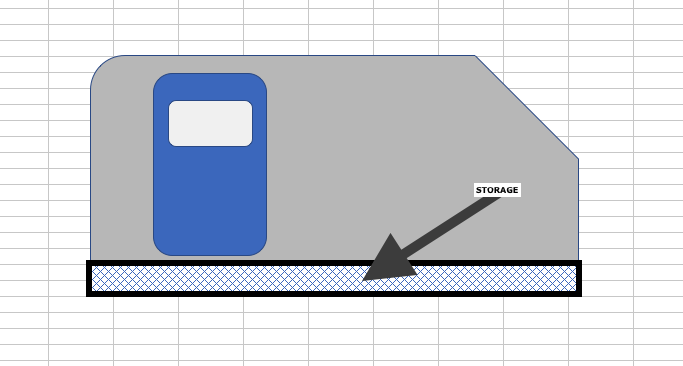

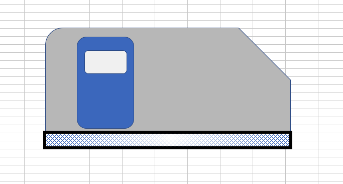

Why not make the deck taller and use it for storage?
Instead of making a 2x4 frame for the deck. Why not a 2x6 on it's side to create a 6" cavity. I could store a folding table, chair, etc.

Again I like this idea. Table, chairs, awning poles, camp stove, water casks, spare tire (depending on the height) could all fit under here.
A con might be that if your trailer has a certain height limit (like 4 feet if you want to keep the sides to a typical 4x8 sheet of plywood, or if you have height limitations in your garage), then any basement storage comes out of headroom. Headroom is a big part of comfort inside one of these trailers. If you are ok with a taller trailer, then this is not a problem. Basement storage also provides a little extra insulation from the cold under your mattress.

The plan is a 5x9x5 trailer, so I am already outside the 4x8 material limitation.
I plan on using 5x5 birch 3/4 ply. I definitely want maximum headroom.

Keep in mind that the bottom of the door opening should be halfway into the mattress. And when you sit down in the doorway you don't need steps to get there.
By the way, 6" of storage space would preclude our camp chairs and roll table.

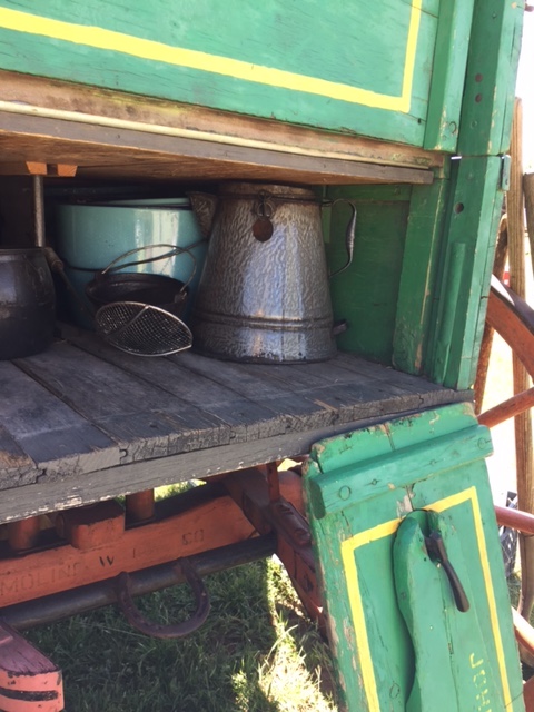

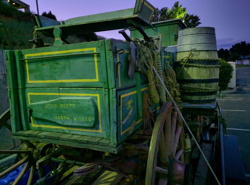

chuck wagon builders installed false floors for storage w/ access from one or both ends
at a glance(to the casual observer) there wasn't a door/gate/hatch cover there
FRONT OF CHUCK WAGON.jpg (100.76 KiB) Viewed 641 times

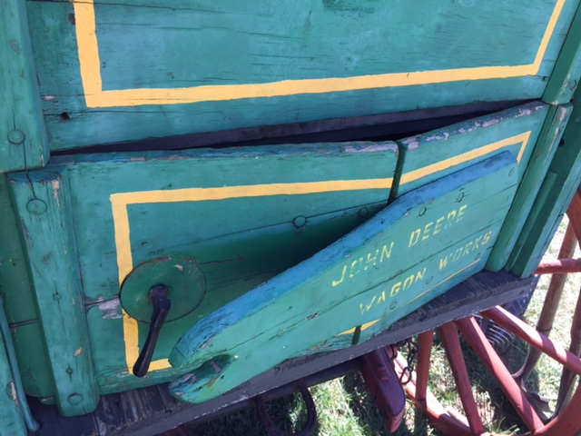

a simple pivot latch was made on the outer board of the hatch cover which was hinged in the center
hinged gate.jpg (127.69 KiB) Viewed 641 times
by pivoting the latch and pulling on the (in this case) left end the hatch cover folds in the middle and the ends come out of their slots
VOILA... you have access to under floor storage
and as you can see... the space is designed around the items intended to travel there and not just a space where one might stash random stuff
