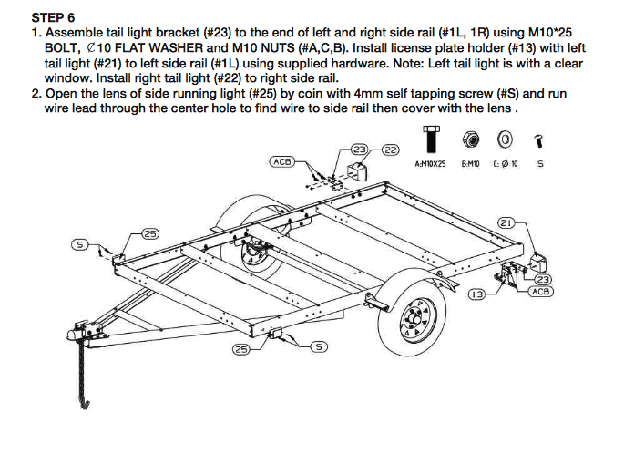

I was about to order the NorthernTool 5x8 trailer when I noticed that the axel is position in the center.
In an early post I it was mentioned you want a 60/40 split.
When I look at images of Teardrops the wheel look even farther back then that.
Do I need to position the cabin forward 2 feet?

if my eyes are correct that whole trailer is bolted together and all you would need to do is drill a few carefully spaced holes to move the whole undercarriage aft IF that's what you desire

It is really easy to reposition the spring hanger on a NT trailer. This is where I placed mine, the hanger is rotated 180 degrees an I placed the existing holes over the rear cross member bolts. The balance is good on my design.
