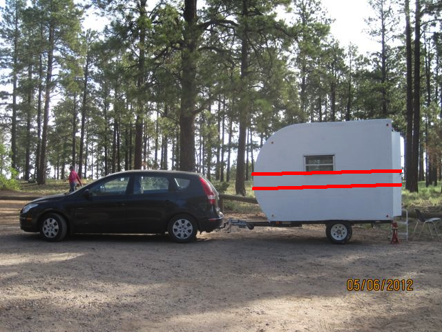

After one of the members had a blow over in a too tall trailer ( and in a terrible crosswind) , the Foamie guys decided it was a good rule not to build taller than your wheel width …
Re: How tall is too tall
Postby Andrew Herrick » Thu Nov 29, 2018 9:43 am
GPW wrote:After one of the members had a blow over in a too tall trailer ( and in a terrible crosswind) , the Foamie guys decided it was a good rule not to build taller than your wheel width …
Sounds like a solid rule of thumb. I'm not telling you anything you don't already know, GPW, but for anyone else interested: You can adjust that rule of thumb based upon the vertical center of gravity of your trailer. A lightweight camper shell built upon a heavy-duty steel frame with underslung water tanks and trailer accessories will survive stronger winds than, say, a wood-framed camper built on a HF/NT trailer with a cargo rack on top. The more weight towards the bottom and center of your camper, the safer in crosswinds you'll be.

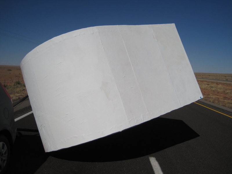

Postby GPW » Thu Nov 29, 2018 2:26 pm
Andrew, when we originally confronted the problem, Foamies being so light and all , it was suggested we bring along 500lb. of Beer as “Ballast" … :beer: To keep the Center of Gravity low …
Here’s a pic of Catherine’s trailer , the one that got blown over … Result was a bent coupler, front frame twist ( the usual ) and a slight scuffing of the covering on the foam … That tall on a narrow frame . For those inclined , you can read about it here… viewtopic.php?f=55&t=44431
