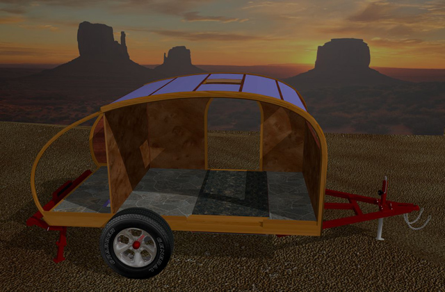

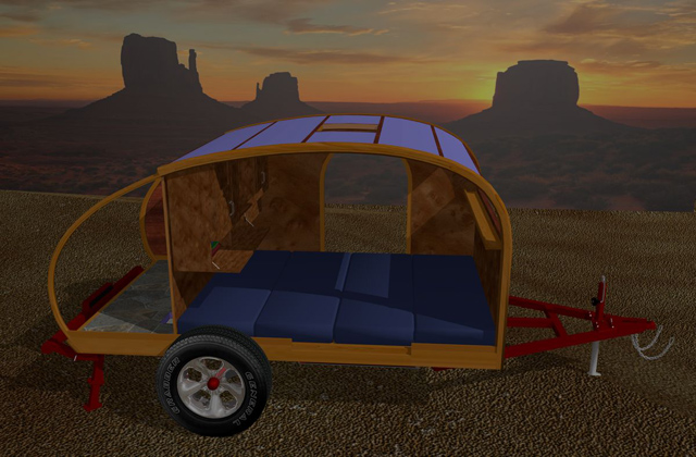

Hi. This is my first post and would first like to thank everyone on here for the inspiration and ideas for my build.

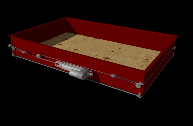

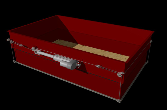

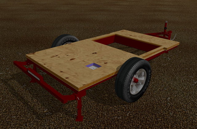

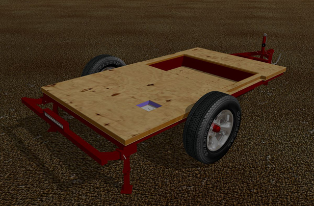

One of the first things I set out to do was to figure out a way to have comfortable seating inside my trailer. I think, and hope, that what I have come up with be a solution to the goal and also give me extra storage room underneath. The concept is to have one sliding box inside another that is operated by a linear actuator. The floor when raised will only be about 3" below the frame bottom. Not the easiest way to do this, but then I never seem to do things the easy way.

Great concept drawings. I like the design.

I wanted it more for seating. The storage is a bonus. I also wanted the seating as close as possible to proper ergonomics. Usually about 17" seating off the floor.

I made bench seats with a table and have never used them as such in the 7+ years that I've been using the trailer. Not only that; but also, if you unmake the bed, you have to find somewhere to store the sleeping bags or bedding; and, storage is at a premium, getting used up quickly. Instead, you might consider having bed trays added or you could raise up the bed a little and have just the bottom flip down with a flip down/up table in front of that. That way, the bedding could stay in place ...Just something to think about. Think outside the "box".

Your design looks sound. Sealing the area between the inner and outer box will be critical. It will be exposed to water pushed at great force when driving in the rain at highway speeds. We use our basement with our futon sofa during inclement weather and are happy we incorporated it in the build.

I honestly don't think I will be using the seating a lot. It was more of an idea that sorta took off. I wanted to see if it could be done. As far as bedding, it would tuck right in behind the rear cushions. I plan on doing a lot of camping in northern Ontario and even in summer when it rains it can get pretty cool. Having and indoor place to sit would be quite comfortable now that I am not young anymore.
