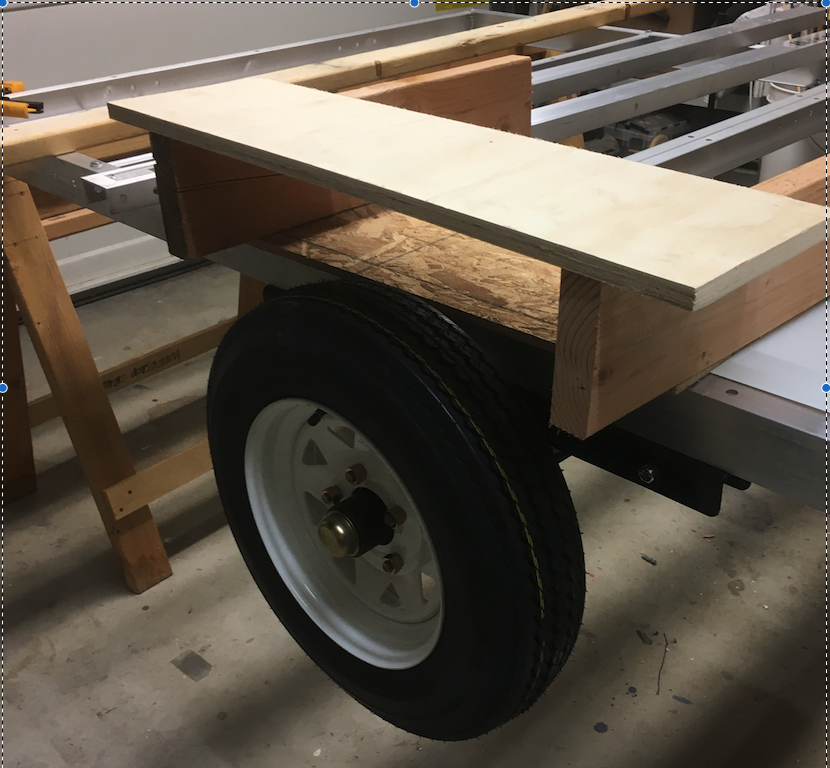

Postby greenchicken » Mon Dec 10, 2018 11:59 pm
Yea... exactly.
My trailer... or at least it's wheels appear to be smaller and/or lower.
Here is my trailer with a 1/2 board, a 2x6, and then another `/1 board. The gap will be accessible from the sides for storing things like a folding table, chairs, etc.
I think is will be plenty of clearance for the wheels without having to to mold an interior hump.

Postby John61CT » Tue Dec 11, 2018 11:08 am
Yes, use side openings and shallow trays, maybe drawer slides to make use of the underfloor if you go that way.
Lifting floor panels under a mattress is no good.
But you see how much more space there'd be with a dropped under floor?
avoiding where the structural bits need to be higher for mounting the suspension and maybe cross-bracing.
I'm looking at the Timbren non-axles for flexibility, minimum framing needing to be up high.
Maybe even a design that makes it easy to lift the whole chassis from a 4" clearance up to 12+".
