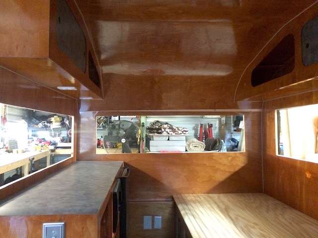

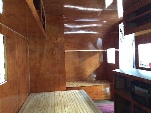

I used the Utility plywood from the Orange store it was just $10 a 4x8 sheet, that is substantial savings for my vintage camper build compared to $24 for 5X5 sheet for 1/8 Birch at my local "real" plywood company. It is not labelled as luan on the shelf. I love it because it is super thin at 2.7mm and bends great. It has awesome grain too, you have to search through the sheets and I had to go to three stores to get a good run but it was worth it. These are for interior use, I think people sometimes overthink and have deeper pockets than me, I am extremely happy with the way it turned out.
