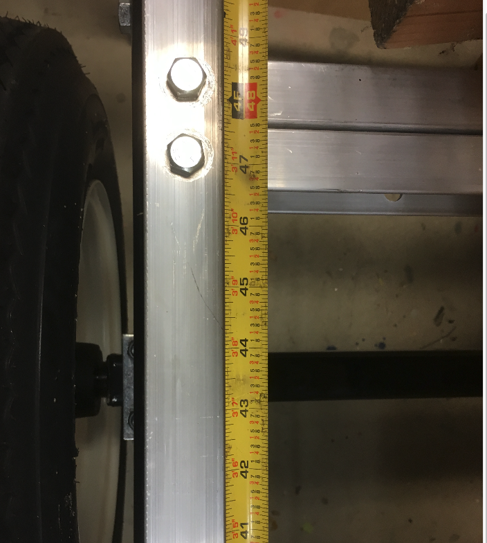

My 5x8 trailer is assembled and this weekend I will build the deck.
The axil is located at 43 inches, about 4 inches back from center.
If I need to move it I would have to 8 inches to clear the middle bolts.
This would make it 35 inches.
Not sure how to calcite the ratio. But as a percentage
I am currently at: 44% of center.
I can move it to 36% of center.
So the question is, can I leave it as is or do I need to move it.
My preference is NOT to move it.

The relevant factor is the tow ball weight after the buildout, should be 8-12% of the total.
This is important to safety, although good brakes on the trailer and just driving slower goes a long way to mitigate suboptimal weight distribution.
