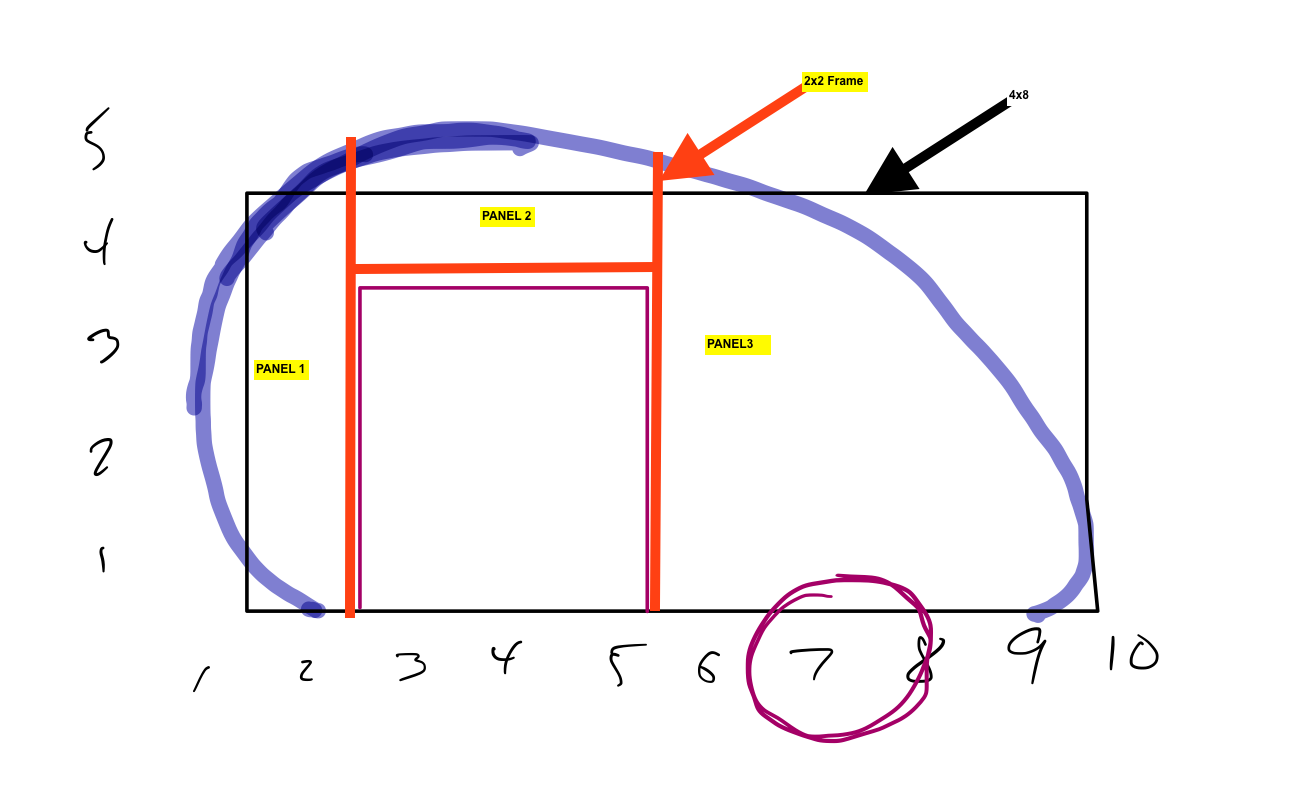

From what I see so far there are two type of wall: One solid wall on plywood, or a frame with panels attached.
The one solid wall looks like the most common. Anyone care to explain the pros/con of these two designs?
My profile will be larger then 4x8 so I will have to biscuit join, or other such method, to get one continuous panel.
But now I have to add the DOOR to the equation.
I want as large a door as possible, on both sides, and have it extend all the way to the deck. My friend's complaint about his TDT is that the door is a few inches above the deck so you can't comfortably sit in the door way.
So that add a concern about the structural integrity of the ONE-SOLID wall design.
Therefore I am thinking of framing the doorway and then attaching panels for the rest.
Very curious for opinions:

I'm a proponent of sandwich walls using skeletonized plywood. The plywood is easy to lengthen using spline joints followed by the sheathing that acts as a gusset.
You can gang-cut both skeletons at the same time:
You end up with a strong, insulated wall with a lip for your ceiling/roof that allows you to build it from the inside out. Which is huge.
That's a 10' skeleton by the way made from 4'x8' plywood. The joint is just forward of the door and the interior/exterior sheathing plys will butt in the galley.
It also allows for a nice deep mortise to slide your bulkheads into. And note the lip that covers the floor:
The door should be half-way into the mattress so you sit on the padding and not on the wall --not all the way to the floor. Your friend's door is probably level or above the mattress. (Ouch).
:frightened:
And p.s. --Your door should be where your hips are when laying down. Yours is too far forward. Otherwise, it'll be a pain to get in and out of. Just make sure your fender isn't in the way.

I am not a woodworker so I built my poor hovel different. The sides were up first and every thing added after. All joints were done to maximise
glued surface area at the joint.
Door opening, the bottom: You will have a mattress inside, up against the door. This will raise your butt up enough to have at least a few inches of wall at the bottom of the door for structure strenght. I made my own doors using the cutout and using boards around the edges for a flange. Then while the door was 7in place, boards were placed on the wall surounding the door making a laberinth seal. This gave strength to the 1/4" ply door and wall and they have been water tight without a gasket seal.

If you don't mind, I'll like to make a suggestion for consideration. The lower front and lower rear curves of your profile add a substantial amount of complexity. Some say that these add to the aesthetics of the teardrop - I'm in that camp - but they will take a lot of time to fabricate. The lower rear curve at the hatch is particularly hard to fabricate, seal against the weather, and construct so that you don't have springback on the hatch.

This is my sis's 4 x 8. I tried to talk her husband out of those front and rear curves. They lost 9" of floor space that way and that's a lot in an 8-foot long 'drop.
I gave him the 9" cutoff.
