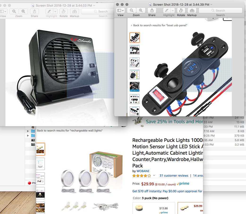

Postby greenchicken » Fri Dec 28, 2018 6:11 pm
Not sure how to answer all these questions but I will do my best:
The Backup Camera will be wireless and attached to the back of the TD.
As for power needs: not that much.
Market is flooded with USB Rechargeable lights, speakers, and so on so....
I plan to have some USB outlet in the cabin for charging phones, and such.
I plan to have one of those cigarette lighter - to AC converter for charging laptop, and such.
I have one of those small projectors, so I would occasionally power that too.
Would be nice to have some A/C power in the pantry for a blender or other such stuff.
I will have the roof vent/fan which I will probably being running a lot on warm night.
The one big power sucker would be some kind of space heater for cold nights.
I have a battery charger which I use for my batteries on my jon boat (to keep the trolling motor going).
So whenever possible I will charge the batteries that way. In general I will rarely camp for more then 4 days. And only using most of the above power at night.
Perhaps TWO Batteries is over kill, my only previous experience the trolling motor which sucked 2 batteries dry in one weekend.

Postby tony.latham » Sat Dec 29, 2018 12:18 pm
I had a similar heater in my first (commercially built) teardrop. It sucked a lot of juice and put out a negligible amount of heat. And you won't get anything else from a 12-volt system to do you any better.
Get a down comforter and you'll be cozy warm.
