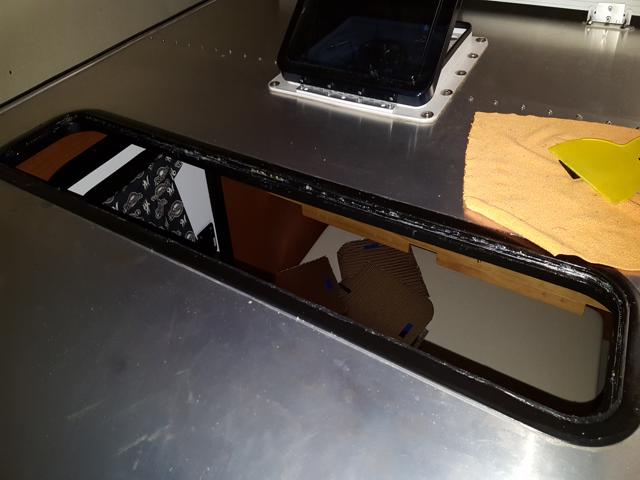

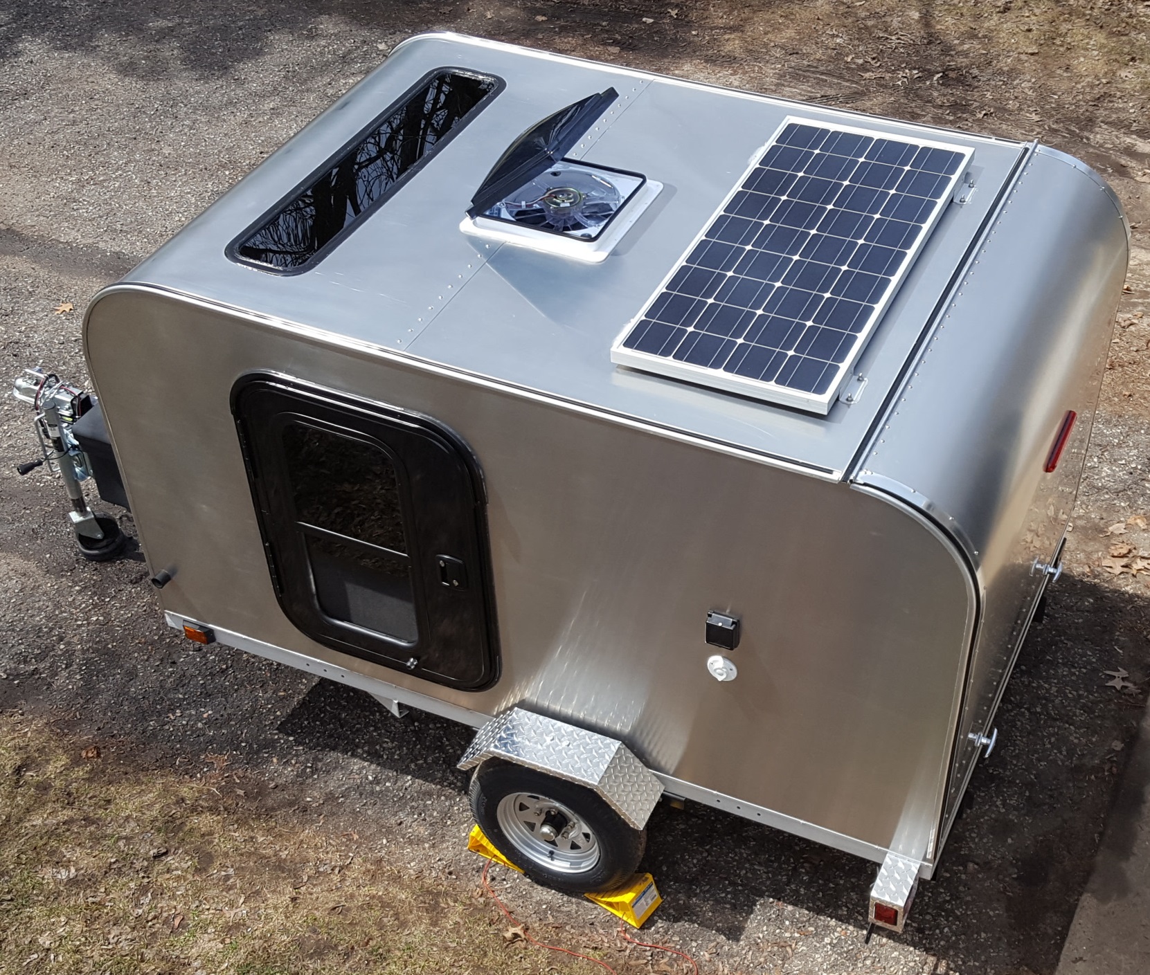

My Stargazer window is leaking. It leaks where the glass in held into the frame of the window. The window is held in with silicone. Looks like whoever assembled it, missed a 2" section with the silicone. The window is on the top of my teardrop and I was always told NOT to use silicone on the top.
I am going to take the window out and re-seal it to solve the leaking. (Yes, I already tried to caulk it with Proflex but it will not stick to the silicone-that's why I'm taking it out to do it correctly)

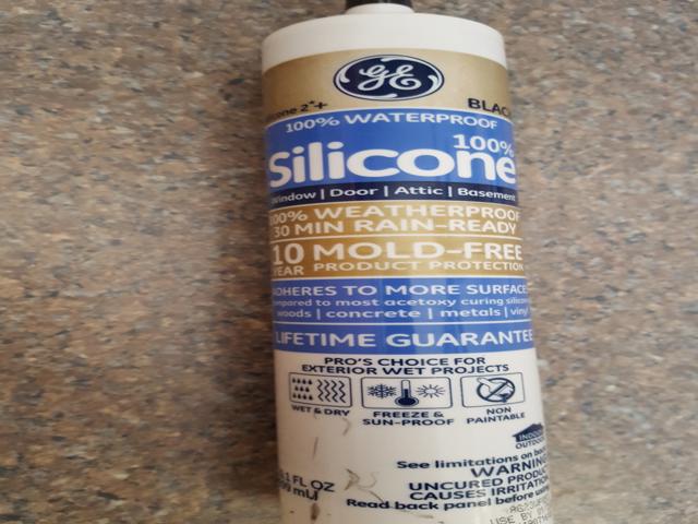

I went with GE 100% Black Silicone sealant.
I used WD-40 to loosen and remove the old sealant. Then cleaned the glass and window channel with rubbing alcohol. Ran a bead, plopped in the window, and now it has to set for 24 hours to fully cure. I will trim any excess sealant, replace the window gasket, and complete a leak check on Saturday.

I will keep an eye on it. I went with silicone based on Challanger Door's recommendation. It won't be fully exposed to the elements because there is a rubber window (glazing) strip that is installed over the silicone sealant.
Hope I'm leak free now. I will check on Saturday and report back after a water test.
p.s. If anyone has to remove silicone use WD40. Wow! I was impressed at how good it worked. Spray on, let sit for 15 minutes and clean up works great!

Postby Minics04 » Sun May 12, 2019 11:38 am
Short answer-YES!
I removed the window from the frame. I sprayed the wd-40 around the glass edge on both the outside and inside of the frame, let it sit, then slowly worked the sealant loose with a screwdriver, thin putty knife, and razor blade. I worked from both side outside and inside. A razor blade got into the sealant on the inside between the glass and frame very well. If I felt resistant,I sprayed more wd-40 as I went. Sometimes, spraying and waiting for it to loosen the sealant. I worked the glass very slowly to not destroy the glass. Take your time, It's a mess. The window came out much easier than I thought it would.
I spent a lot of time and effort to make sure the window from was free of wd-40 and old sealant. Using a plastic putty knife to scrape the old sealant away as to not scratch the window frame. Lots of paper toweling. Cleaning with rubbing alcohol.
I applied a GOOD bead of black silicon sealant. It filled up the gap and channel between the window glass and frame on the outside of the frame. I was not to concerned with the sealant swishing out of the frame on the interior of the frame. I let the sealant set up then trimmed the excess with a razor blade. The black sealant blends in very nice.
