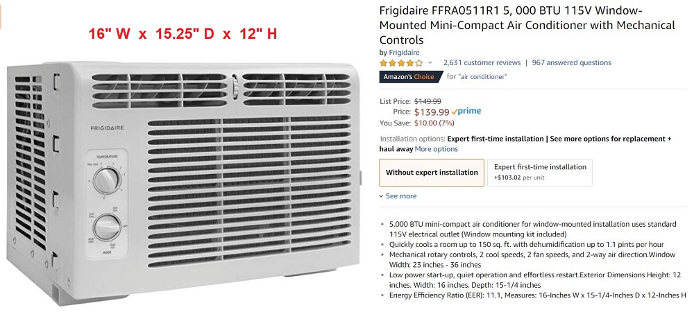

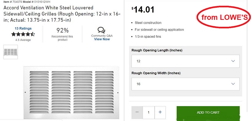

* Build it inside a cabinet, with only the exhaust pointing outside, thru a louvered vent grille to disguise it, with the enclosure supply both ambient air to cool the chassis, and drawing in cabin air to recirculate it. The unit can drip condensate directly underneath the trailer, by attaching a small hose to the drain pan. Fasten the grille directly to your exterior wood/siding/coating, leave it in white (or painted to match), and nothing will show.
use a flat-front A/C unit like this one (my LG unit is angled, not good for cabinet enclosure placement)
5k btu Frigidaire air unit.JPG (151.25 KiB) Viewed 4036 times
grilles can be sourced any size, anywhere, for little $$
12 x 16 louvered grille white steel.JPG (81.97 KiB) Viewed 4036 times

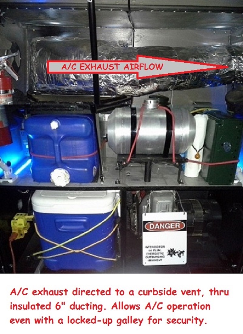

* I should've built my fully internal A/C system this way, instead of using a fabricated right-angle, insulated duct (w/internal axial duct fan, and modified lift-up vent cover.
my way to vent hot exhaust flow out of a fully enclosed A/C (at night) in my 4x8 TTT's closed-hatch galley area 4x8 TTT, so I angled it 90 degrees outside
Air conditioner exhaust ducting.jpg (244.49 KiB) Viewed 4036 times

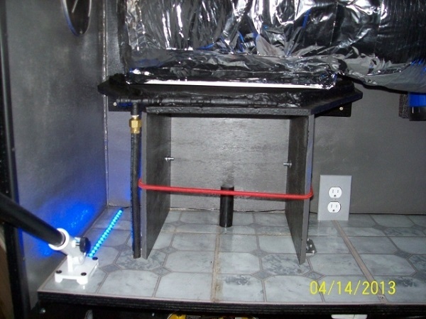

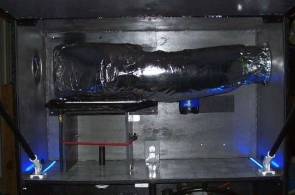

* But, just in case the humidity is so high that an excess of condensate forms, wouldn't you rather have any overflow drip into a drip pan, or onto the ground? Even though most condensate is used internally to cool the unit, current manufacturers installation manuals still demand that the units be angled back for proper function, but not to drill holes in the bottom rear, even if excess water pools there.
* My 4x8 TTT uses a LG lw5012j 5k BTU unit, that I bought because my experience with LG units showed little or no dripping (from a 8k BTU unit in my wife's office-in our old house), whereas we had lots of condensate overflow from our Frigidaires (two 15100 BTU, and one 10k BTU units) most of the time, despite their lack of drain holes. All units were 2011-2013 year models.
* Since its' installation in my TTT's so-called "galley", the little LG has never dripped into the pan I hand-formed for it (from flex-seal on plywood, with drain tube to the underside of the trailer), and probably gets ejected out the exhaust ducting, instead. But the Frigidaires all dripped like Niagara, during very humid weather.
hand-formed drip pan.jpg (94.59 KiB) Viewed 3765 times
ducting overhead, drip pan below.JPG (69.56 KiB) Viewed 3765 times
