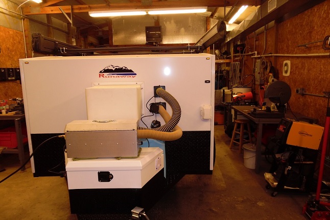

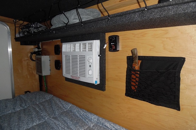

I use the AT Overland Proplex Portable Forced Air Furance for my squaredrop. 6500 btu propane powered that uses 1.4 amp on 12v. onboard self-diagnostic hardware, solid-state electronic thermostat will automatically ignite and run until the cabin reaches your ideal temperature. The electronics constantly monitor the operation of the heater to make sure everything is operating perfectly. The flame, case temperature, combustion airflow, gas solenoid valve and voltage are scanned continuously. If a problem is detected the heater will instantly switch off & the red light on the thermostat will flash in code to let you know what is wrong. The heating system is pricy IMO for us well worth it. I added the Climate Right Air Tite Vents
