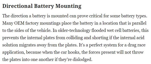

* I use an AGM battery in my TTT, but only because I want to just leave it out of sight, buried within my tongue box, under levels of gear, and not worrying about out-gassing, or having to periodically check the acid level inside it. I only need to look at it if it won't recharge, someday. And, I don't have to worry about the lead plates inside (if it was a lead-acid battery) vibrating loose and shorting out. That was a concern, back in the day, when we only had lead-acid batteries in drag-race cars, and no dry cells, Gel, or AGM batteries.

* In my drag-race Chevelle, I installed the 2 lead-acid batteries as far rearward, and as far to the right/left quarter-panels as I could (rearward for traction, and leaving room for a fuel cell in between them). I placed them lengthwise in the direction of travel, since that is the direction of most force acting upon them. No problems. When I used a single Gel battery, and a dry cell before that, it didn't matter, and they were mounted in the engine bay, wherever they would fit (the stock location was replaced with other items).
* I've seen many street cars with batteries mounted in all sorts of places, so in typical usage, vibrations/placement/engine bay heat didn't really concern the manufacturer...but it did matter when hard-launching (with front wheel lift-off) made watching out for vibration, heat, and proper alignment necessary.
