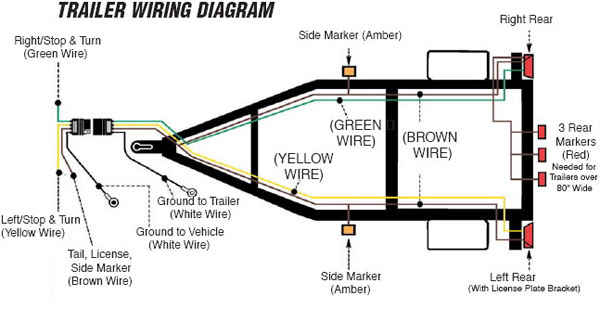

First the color of the wires on the light and your harness do not have to match up.
The right side needs the running lights, right turn/stop and common.
The left side needs the running lights, left turn/stop and common.
A total of 4 unique wires.
Typical for a 4 wire system (in this order typically)
Common is white
Brown is running lights
left turn is yellow
right turn is green.
your lights' yellow should be connected to the brown
your lights' white to white
your lights' brown to the yellow or green.
From: https://www.etrailer.com/faq-wiring.aspx
Obviously, your colors may vary.

here is a pic of "standard" plug configuration
if i read your OP you have the 4-WIRE FLAT plug
note the location of each circuit in relationship to the ground
ground, tail, left, right (this is common)
here is a pic of common trailer wiring
