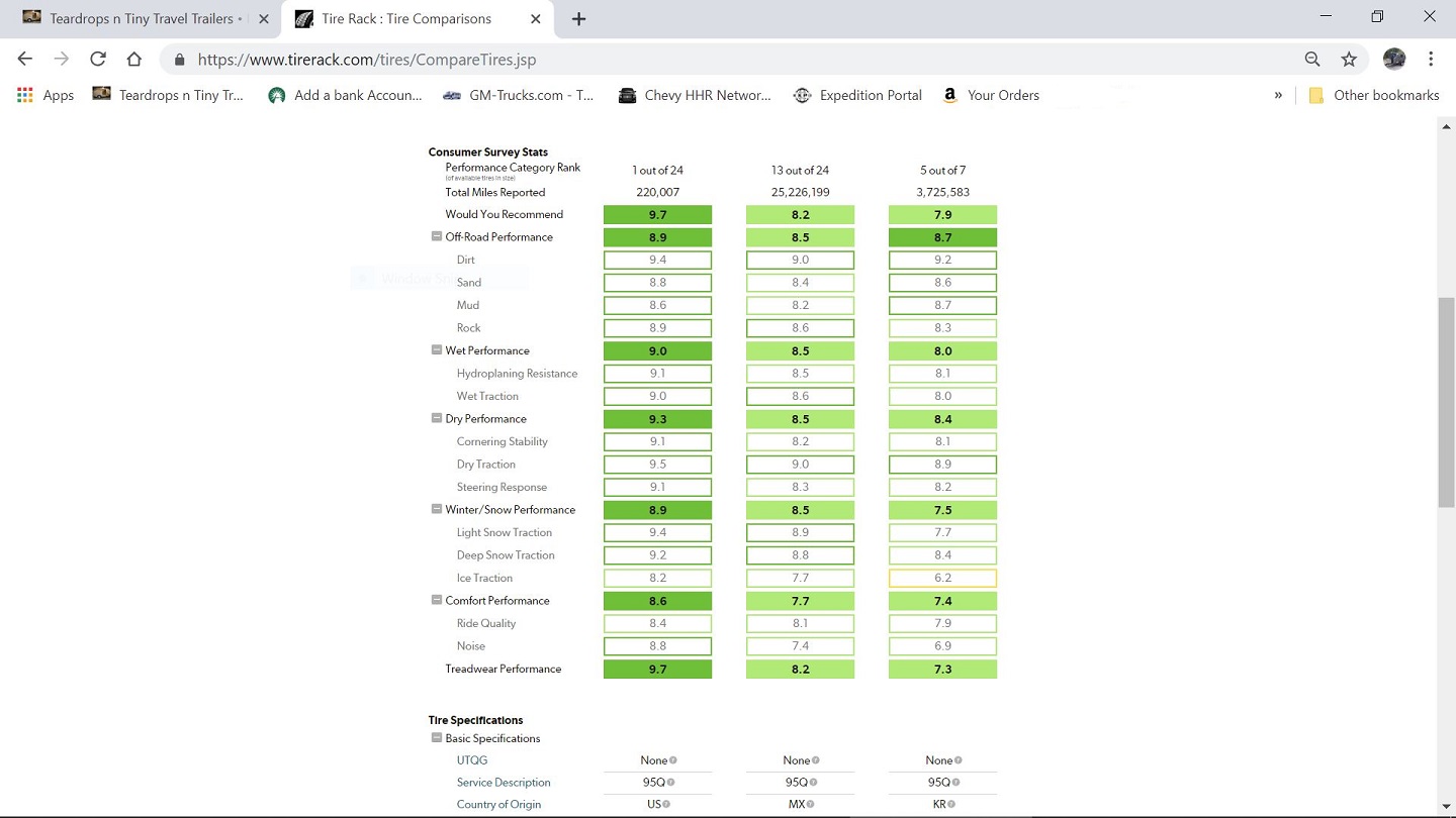

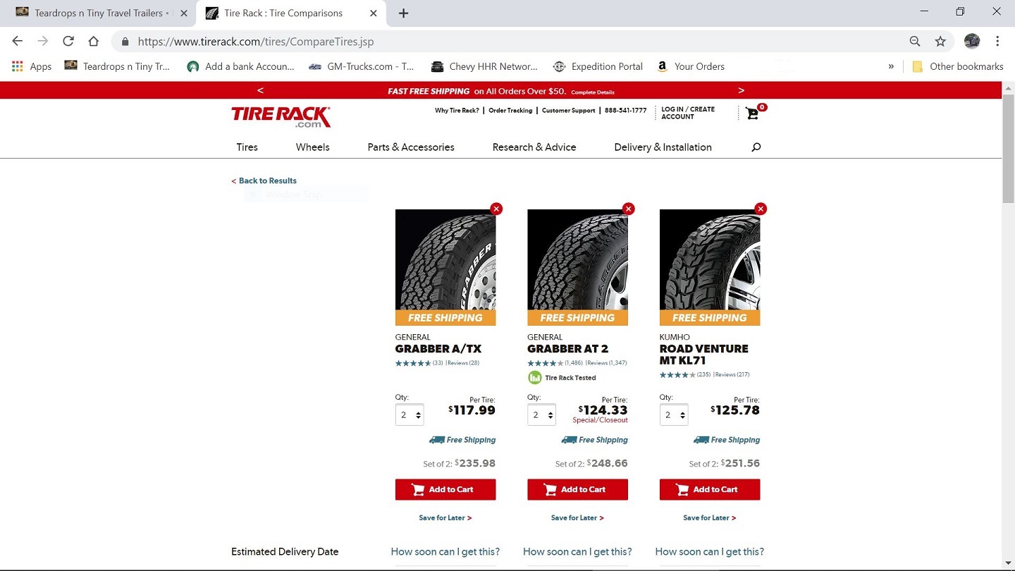

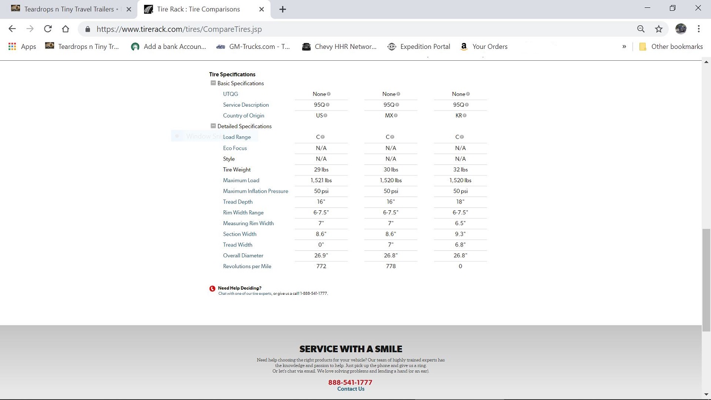

* When I finally accepted the fact that my 12+ years-old Carlisle bias-ply ST tires (with multiple repairs on each, and with cracked/hard rubber) were untrustworthy, I looked for suitable "non-Chinese"-made replacements (preferably bias-ply, with stiffer sidewalls than radials) and found none. I was looking for 14" tires, also, and that size is slowly becoming less well-represented in the tire market, anyway, so the selection wasn't large overall.
* I decided that the best (read: judged the best for my planned usage, best type "in my experience") tires were LT (light truck) tires, with a C load rating, deep all-terrain tread (for many road conditions), and with stiffer sidewalls than ST & passenger car radials (my 4x8 weighs over 2k lbs). I bought General Grabber AT2's in 27 x 8.5 -LT14 size, two from Amazon, and later one (for use as a spare) from Tire Rack. I run them @ 50 psi, and they are all that I'd hoped-for, after 2k miles (absolutely no treadwear or scuffing).
* At the time, I could only find two 14" LT tires offered, the AT2 all-terrain, and a mostly off-road Kumho mud tire, so I opted for the on/off road AT2. Now, General offers an improved version of the AT2, the A/TX, which is made in the US (AT2 is made in central Mexico). That fact alone would've made it my choice, but the Mexican factories seem to make a good product (heck, my '09 Chevy HHR Panel, which was bought to fill a specific niche/need at the time, is 40% Mexican-made, assembled there, and it has 170000 hard miles on it...).
* I looked at a tire comparison/customer survey on Tire Rack's website, which highlights details of the three aforementioned tires (in three screen snips):
* But, you've already made your purchase of new 14" ST tires. Good luck with them, I'm sure they'll be fine. I am just offering this info as an alternative to others also in need of replacement tires, seeking something other than unreliable Chinese-made products.
