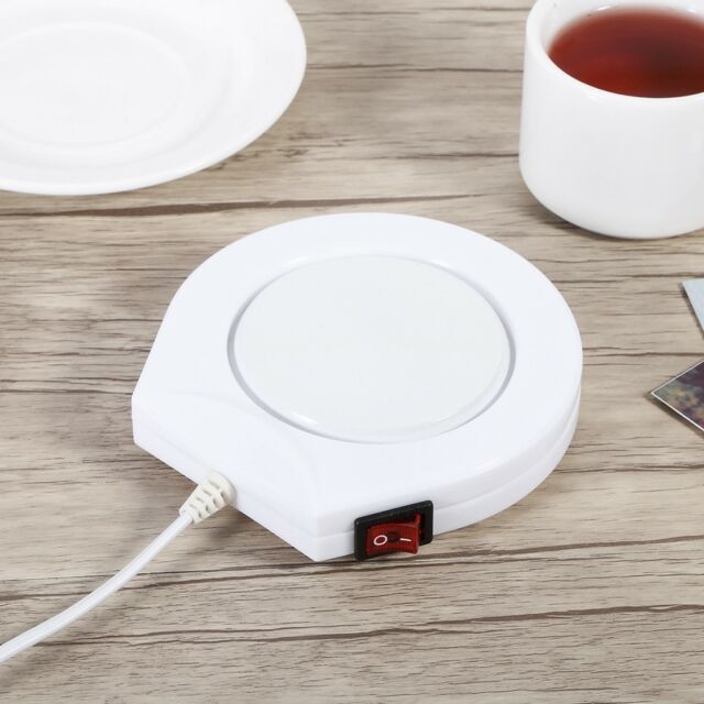

organic fungicide . For the small shop no way to turn organic fungicide in to a gas. organic fungicide has an short life .With sulfur can be turned in to a gas with a sulfur burner . cheap 110 coffee cup warmer tent made from cheap tarp the Ph. in the sulfur will kill mold and light coat everything stopping air born spores .Will smell for a time better than dying .https://www.ebay.com/itm/2-Pounds-Sulfu ... xyFiRR0vxV Ware a mask fresh air paper coverall . Start with bleach 5 to 10% every where . It is the spores that get you.
