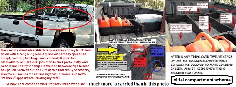

* Storage is my Achilles' heel... I'm never happy with what I've got, or where it's stored. This time, my project is on my tow vehicle, not the 4x8 trailer.
* I've previously posted about my compartmentalized truck bed storage scheme http://www.tnttt.com/viewtopic.php?f=2&t=68912&hilit=+compartment#p1210246, which works OK, but since I now leave my gear and tools in the exposed bed in the uncovered driveway, year-round (tired of loading and unloading it), I have to cover the bed to limit the leaves and debris accumulating there; it's always parked beneath two huge oak trees, and the amount of leaves and oak pollen it can collect is staggering. I've been using a 6x8 tarp for the last year, and while it does the covering job well, it looks too "redneck" and unsightly for my wife, and we seldom use the '04 Chevy Silverado 2500HD anymore, between my camping trips. It has the least # of miles of any of our four vehicles, and is in top condition, so I'd like to use it more often around town...so I'll make a semi-hidden bed-cover that will not shame my wife anymore.
tarp is always on.JPG (153.36 KiB) Viewed 3727 times

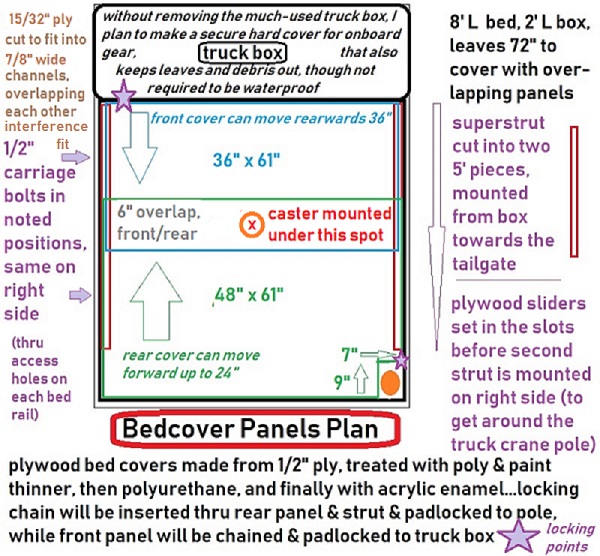

*I just can't bring myself to purchase a factory-built cover, even a velcro-attachment type for $150, while the hard-cover types I like cost up to $1500. Plus, I won't remove my big cross-over toolbox to fit one in (no cover I saw exactly matches the size, and the alterations I must make to fit one in, with the truck crane that I'm keeping in the bed, too). I've envisioned a two-piece plywood cover that will sit in a channel just under the bed rail height, mostly hidden from view. I'll paint it black, like my truck box, and it will leave room for bull-ring attachment points on the rails, so I can still haul items strapped on top of the plywood covers. Larger, heavy items that need to be hauled will fit into my wife's highly modified-for-towing '98 GMC Sierra.
Bedcover Panels Plan.jpg (156.36 KiB) Viewed 3727 times

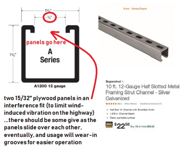

* I'm collecting the parts now, and only need the plywood, poly, and paint to start on it. I've been considering doing this for six months now, and am finally going to do it. I'm using the 12-gauge Superstrut from Home Depot, which will be mounted about an inch or so below rail height, all the way forward under an overhanging lip on the crossover toolbox. I'll mount the left channel first, before inserting the panels into the slot, then put the second channel over the opposite edges, and lower it down into position to insert the second set of carriage bolts into the holes already existing on the right side bed rail. I'll probably need a handle on each panel to help me slide them over each other, since together they're thicker than the slot they go in (there should be some give, and eventually they'll wear-in a groove to enable easier movement...better than too loose a fit to start with).
Superstrut channel.JPG (88.05 KiB) Viewed 3727 times

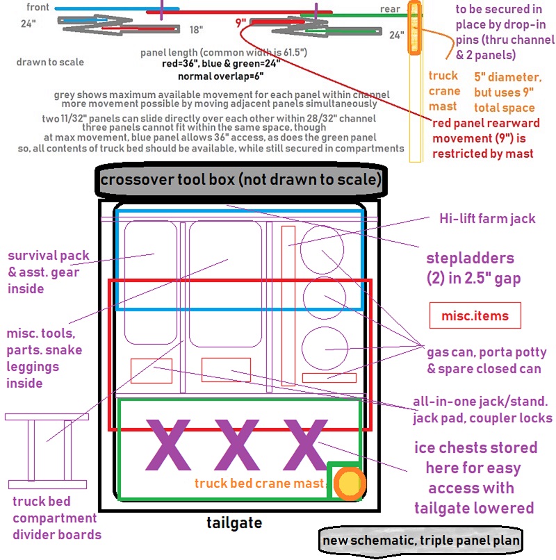

* I've re-measured, and re-drawn my plans, changing from a two-panel to a three panel bed cover set-up. The previously mentioned 36" and 48" panels would've made access to my existing compartmentalized storage underneath too difficult, so I've changed the plan to using one 36" panel, and two 24" panels, instead. The side-to-side measurement remains 61.5", though. Now, I just need the wood, two pins, and the replacement bull-rings, and I can make it happen. While the wife's away.... :roll:
front panel (blue) overlaps red, which overlaps green, to keep highway speeds from forcing debris/some rain between panels...panels are meant to limit debris inside truck bed
new schematic, triple panel plan.jpg (244.83 KiB) Viewed 3386 times

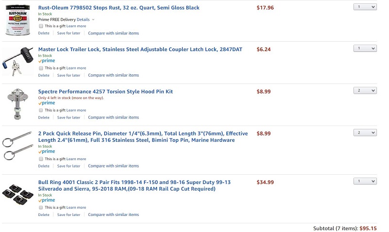

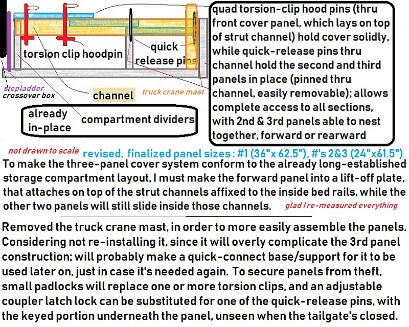

* Still waiting to buy the plywood panels, but I'm glad I waited. Constantly re-measuring and testing configurations, while the wife was out of town, made me re-think all permutations of the ways I've stored my stuff for years, and the way I can best retain that system...I really don't want to re-make my bed dividers, so the cover has to follow their lead.
* So, I've come up with a FINAl revision, that I'll stick with. It'll require more small parts (latching pins & hold-downs), and replacement stake pocket anchor points for my bed rails (the existing ones were destroyed in removal, so I could install the Superstrut channel in thru the pockets), plus another qt. of paint (the previously-bought can disappeared).
3-panel truck bed cover project, remaining parts list 5-27-2019.JPG (94.87 KiB) Viewed 3306 times
* This $95 shopping list, plus the two sheets of CDX plywood (about $40-45), added to the $65-75 I've already spent, will make this project's expenditures slightly more than what the cheaper vinyl bed-covers on Amazon cost. And yes, my wife will protest! But, I've never seen a cheap vinyl cover last very long, and considering the way I'd use one, surely would last even less time. So, I'm making my own substitute for a factory-made cover...it'll be good enough for what I need, and since my old '04 truck isn't new or fancy, it'll fit-in just right with my redneck-engineered projects, and should be durable and last for years.
* I removed the truck crane mast from the rear corner of the bed, since it was making the panel alignment a bit wonky (I needed the two rearmost panels to slide completely atop each other, but the 9"x 9" area, containing the mast & its' lateral support arm, precluded this). Without the crane (useful for strapping tall items to, but mostly unused for moving engines around anymore) in the way, then the back two cover panels (24" x 61.5" each), can be moved together, forward or rearward in the channel, as required. Another change, is that the front/top panel needs to be mounted on top of the strut channel, since my existing storage boxes in the bed are so long, the covering panel needs to be completely removable to open the longest box (38") while the other panels slide clear of it. Since this panel is the one that will see most wear, and possibly being stood upon, I can use 1/2" plywood (or even 3/4"), instead of the 11/32" ply that the strut channel opening dictated. Weight isn't a factor (my truck can carry/haul 12000 lbs.), but durability is.
final plan revisions, maybe.jpg (297.2 KiB) Viewed 3306 times

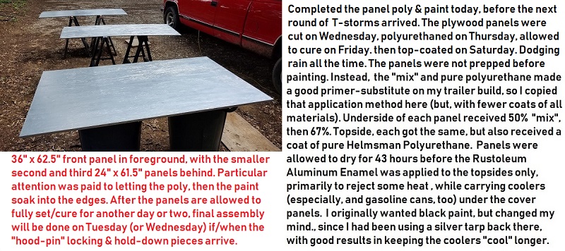

Postby working on it » Sat Jun 01, 2019 11:45 pm

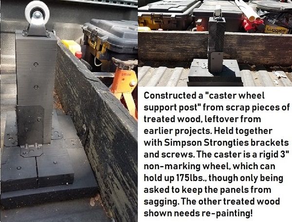

* Got closer to the finish line today, having completed the polyurethane & aluminum paint coatings on the three panels. I've had no shelter from inclement pop-up storms lately; there's no room inside the garage. or inside the workshop available, after the wife kept everything from the old house and stored the mess in our work spaces. So, I have to paint outside between storms, and finally, it's all over, after waiting many days for a window of opportunity.
* The plywood I bought is barely adequate, not as good as the 3/4" ply I used on my trailer, but I had good luck using the poly/thinner on that plywood, so I treated the panel plywood much the same as in the trailer build, using the "mix" to plasticize it and make it as water-resistant as I could, in lieu of using ground-contact plywood (unavailable in the thin sizes I used). I took less care with the underside of the panels, but made the topsides more rain & sun protected, by applying extra-poly, and an aluminum enamel topcoat.
truck bed cover panels poly'd & painted.jpg (209.07 KiB) Viewed 3220 times
* I also made a support post structure, with a soft caster wheel atop it, to keep the thinner rear two panels from sagging, and to aid in sliding them when access is needed. The front section, probably won't sag, being made from thicker plywood, but I can always find more scrap and leftover brackets to make another.
caster wheel post assembly.jpg (140.55 KiB) Viewed 3220 times

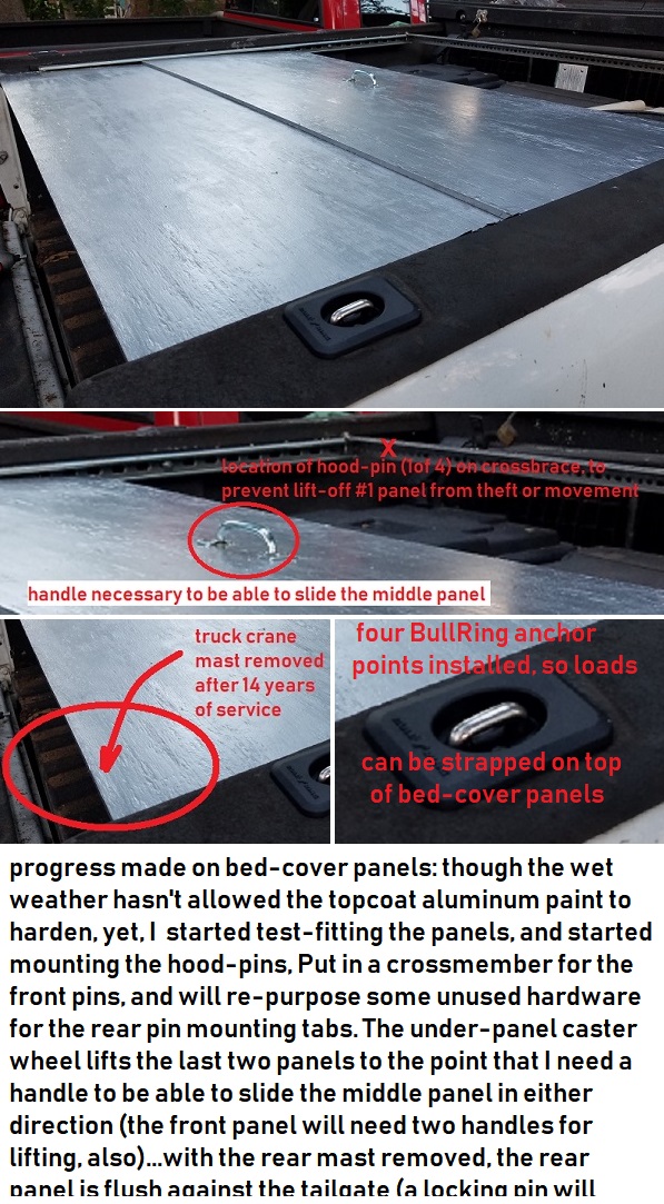

* After waiting for parts to arrive, and for the aluminum topcoat paint to dry (slow to do so, in a garage that retains humidity, with frequent rains here lately), I wasted two days, and since the weather never seems just right, I did a little work (2 hours) on the project, while I could. The paint was still slightly wet on the edges, but I went ahead anyway, as this afternoon might be my best chance for a couple of days.
* I started to test-fit and locate positions to drill mounting spots for the 4 hood-pins that will secure the front/top lift-off panel. My leftover bracket supply is sparse lately, so I used a piece of slotted angle to make a cross-member to locate hood-pin holes in, and that will also support the front edge of the panel. It is 9.25 inches to the rear of the cross-over toolbox, and located so that it will not impede any possible loading situations I may have. Then, I think I'll use a pair of hasps (leftover from my sidewall-storage boxes project) to allow the rear set of hood-pins to drop down, and out of the way, whenever the cover panels aren't in use, but I ran out of daylight before I installed them.
* Of course, I banged up the undried paint a bit, and drilled some holes in the plywood panels, so resealing and touch-ups will be needed. But, I think that this project might turn out OK, after I make a few tweaks here and there.
last line should've read: rear panel will also receive a locking pin (hitch-coupler adjustable length lock)
truck bed-cover panel progress as of 6-4-2019.jpg (323.7 KiB) Viewed 3125 times

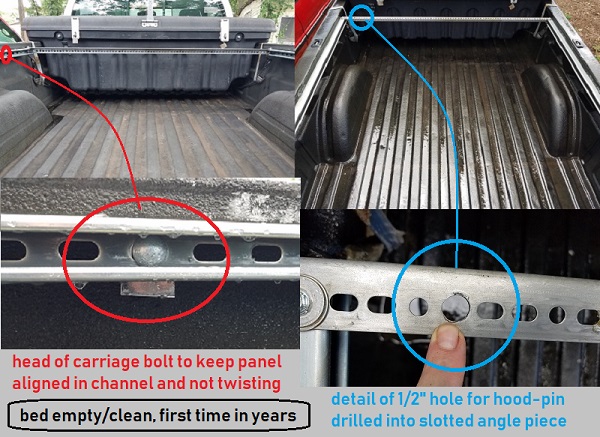

* Another day with "iffy" weather, so I decided to clean out the truck bed, instead of working on the panels, in case of a sudden shower interrupting me. I hadn't removed the compartment divider boards for two years, so there hasn't been any cleanup there for as long. Since I only started covering the bed with a tarp about this time last year, whatever leaves, oak pollen debris, dirt and whatever else falls from the sky has accumulated in the truck bed, so I figure that I'd make a clean start.
* When the panels are installed, there will still be two openings for debris to enter: one is between the crossover toolbox and the rear window, and the other is the 5.5" space behind that box, where I carry my folding stepladders (it's hard for me to access the truck's toolbox or bed storage items without them (I can no longer use a tire to leap up into the back, anymore). I'll see if I have any conveyor belting leftover, and I'll make flaps to shield those gaps.
* In a previous photo, I mentioned that the divider boards needed painting, so I'll do that before re-assembling the compartments. and another thing, I'll need to get more 1/2" carriage bolts (like the ones I used to mount the strut channels to the sidewalls), because I cut the panels' width to fit inside the channels with the bolt heads inside the channel...when I put the panels in the slot, they tended to twist sideways inside the channels, as they went past the bolt heads (two bolts, front and rear on each side, with none for a 4-foot span between them), The middle panel tended to cock to one side and either stick inside an internal slot, or leave the channel on one side entirely (no problem with the rear panel, because it had bolt heads in its' portion of the channel). I found two more bolts, and they helped, but I'll need an additional several pairs to take the free-play out of the equation.
* I'll also need to re-mount my Hi-lift jack, since the covering panels required that I remove the home-made mount I had used. It also was locked to the truck crane mast, that's now removed also, so I'm going to mount it on the rearmost bed divider board, if the ice chests will still fit in that slot. I want it out-of-sight, as is my camp shovel (under/behind the stepladders), as not to tempt sticky-fingers at Home Depot or Walmart parking lots (prime theft opportunities, for the ethically-challenged shoppers).
* As you can see, each step of the bed-cover panel installation requires panel modifications, changes in peripheral equipment, added supplies ... more paint, more hardware, another set of 4 padlocks (this'll bring my total "at camp" # of padlocks to 26), etc. It's just like in drag racing...if you change one thing in your set-up, you'll likely have to change four more.
* Today's photo collage:
empty & clean truck bed, detail shots.jpg (146.1 KiB) Viewed 3090 times

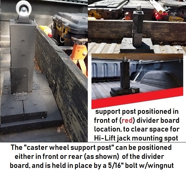

Postby working on it » Fri Jun 07, 2019 5:23 pm

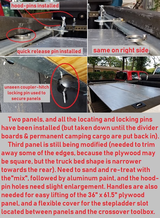

* Decided to wait on getting more parts for the project, so I've been trying to make do with what I've got, including tools. I scrounged around my wife's shop/junk catch-all building, and it took me two days to find a sander. There isn't three square feet of clear space in there, and of course, the sander was under a couch (which is under other stuff). I can't believe how few years it takes to completely fill so much space (we had everything nicely arranged in three sheds/shops, a 3-bay garage, and our house, only 10 years ago). I think I am as bad as her, since I never throw away a nut, bolt, scrap of material, or automotive and building supplies. I know I have what I need to finish any project on hand...the problem is laying my hands on them.
* I had to trim some off the main panel, which is square but my truck bed tapers a bit more than I accounted for, so that's why I needed a sander. Wasted at least six hours looking, before I found one. And, along with the sander, I found my missing Rotozip, which I could've used to enlarge the four hood-pin holes, since they were impossible to snag while holding the 30 lb panel at arm's length (and me with a bad back, shoulder, and no grip in my left hand!); instead, I had already used a tiny Dremel grinder bit that broke, and followed that with a rattail file. I bought a good air compressor last year to be able to use air tools, and I already have a die grinder, but it too went missing....just the way it is around here.
* Anyway, I'm using PL Premium adhesive to seal exposed plywood in the holes and where I sanded; it'll work as good or better than using the poly "mix" procedure, and is a lot faster. While it's drying, prior to touching up with aluminum paint, I touched up the weathered divider boards from the bed (using some old spray cans left in her shop), and found two more handles to attach to the panels, making them easier to install/remove. I have one more handle to install, and I'll put away everything (rain is always a possibility), and will resume with the touch-up paint this time tomorrow. So maybe, just maybe, I can finish the project this weekend?
* Here's two pics from last night, I don't have any from today:
getting closer to a finished project.jpg (236.63 KiB) Viewed 3046 times
needed to move the support to have room for the Hi-lift and 2-3 coolers at the rear
caster wheel support post assembly alternative placements.jpg (162.63 KiB) Viewed 3046 times
