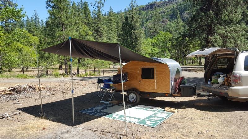

My trailer has a rear door, which makes it kind of unique in the teardrop world. I’ve been looking at how to make or purchase an awning that would keep us dry when we open the rear door when it’s raining out. This pic was taken on our last camping trip, and it rained almost the whole weekend.

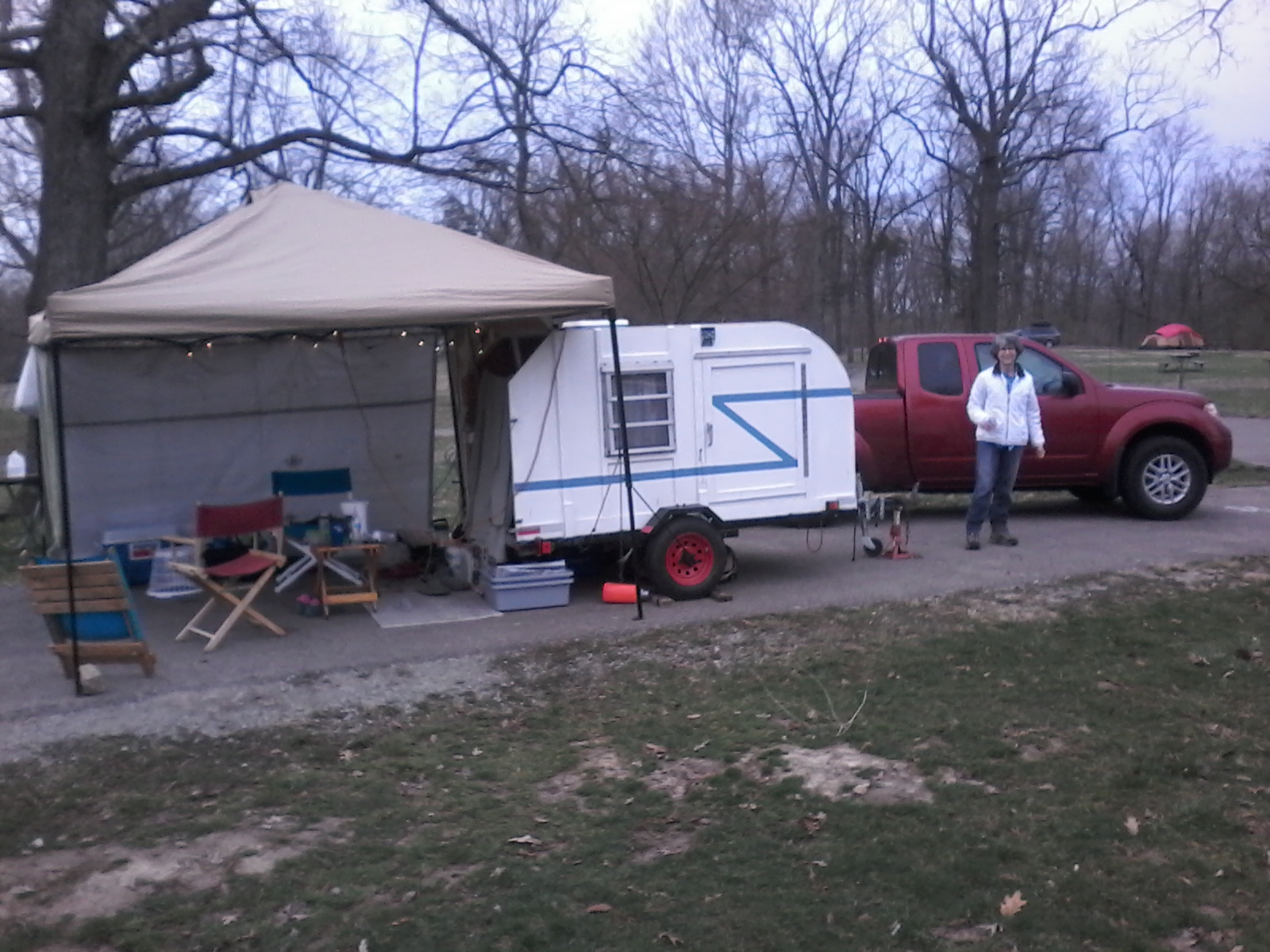

We place a 10x10 canopy at the back of our camper and lift the hatch up into it. You could do the same.
