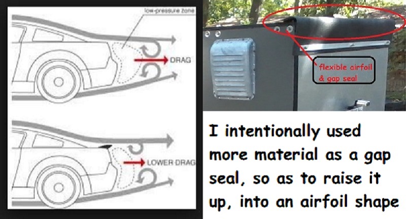

* I was thinking along those lines, when I started my trailer build. And then, because I had built too heavy for my originally planned tow vehicles, I threw aero out the window, and relied on the brute strength of my pickup to tow it with (it doesn't matter what it weighs, the mpg's stay the same). The airflow over the tailgate pretty well matches the spot where the trailer's front slope begins.
* from another thread http://www.tnttt.com/viewtopic.php?f=2&t=67589
working on it wrote:My original concept was to make it simple, strong,and with a 45 degree front slope for aerodynamics (since I couldn't bend 3/4" ply). The Kammback was also in the original plan, though I used a semi-rigid piece of conveyor belting to create the Kamm effect. Aerodynamics was always a factor of the design, because I had intended it to be towed in the air shadow of either my wife's Cobalt (@55.5 inches roof height, and roughly 40 inches at the trunk), or my HHR Panel (@63 inches roof height), while the trailer's front began sloping back @ 40 inches, rising to the roof @70).
* But, it ended up way too heavy to be towed by either (1600+ lbs, way over their tow limits of 1000 lbs each). Ended up towing with my HD truck, so the aero is not a factor, nor the weight. The trailer doesn't affect mpg at all; truck doesn't even notice it there. That's ok, though, since I started out wanting it to be semi-off-road capable, despite the Cobalt or HHR not beng capable of off-roading in the least, so weight be damned, I was able to keep adding more features (+weight) and a stronger undercarriage (3500lb axle, heavy-duty springs) to make it more off-road capable.
* Since then, the trailer weight grew to 2150+ lbs, and I built racks on the front/top (and now sides) to carry all the gear, so the aero is even worse. I did clean-up the open-bed of my truck recently, and covered it with hard panels, so it probably counteracts some of the negative aspects of the trailer's shape & exterior cargo. Another thing that possibly helps: the raised conveyor belting on the rear top edge of the trailer (it covers the gap when the hatch is opened) breaks up the linear flow over the top, and reduces the suction/partial vacuum at the rear.
stiff conveyor belting used to cover hatch "gap" when opened (shields gap, breaks up laminar airflow to decrease suction effect behind trailer)
top deck airfoil.JPG (109.08 KiB) Viewed 829 times
