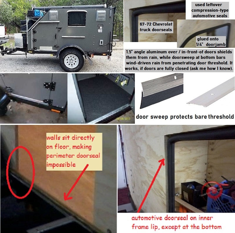

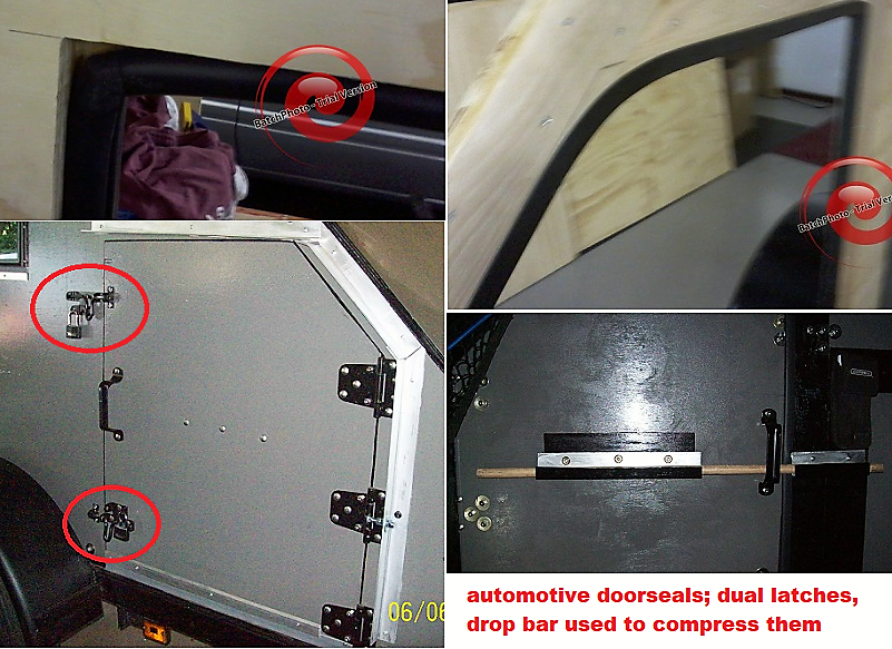

* My camper started out to be a "no/low budget" build, using whatever I could readily find locally, or re-purpose from parts on hand from other projects. I also decided to build it as a simple, angular squareback, using only straight cuts, and thick 3/4" plywood (with no insulation), so it would be very strong and easier? to construct. Certain design decisions I made (45 degree front sloped roofline, and a forward-of-normal door placement) made making my own doors a necessary choice. I cut them out from the sides, and used a method similar to Tony's, to seal them.
* As for using no windows in the doors: I enter the trailer headfirst, with my feet at the door end side, so windows there would've been subject to accidental contact, and possible breakage. And, I wanted awning-style windows placed up high (for more privacy, and security), so none could fit into the doors anyway. I tried making scale-model Wiley windows, but didn't like the way they worked, or looked, and finally bought the awning-style windows I had bookmarked as my first choice, 2 years before I bought them (the windows were bought/installed after the rest was 99% already finished). Here's the way I made and installed the doors and parts I used.
working on it wrote: from another thread I used compression-type automotive doorseals, that I had leftover from restoring my old '69 Chevy C-10 pickup (I wish I still had it) in the late '90's. The seals are mounted on the 1/4" inner doorjambs of the oak bracing surrounding the solid 3/4" plywood doors (totally sealed with "the mix", and multiple coats of poly and paint), and the bottomside has an exterior doorsweep hanging down as a drip-edge, protecting the aluminum threshold there (no rubber seal there, just a wood/aluminum interface).
* Another thing about using those leftover seals from my truck restoration: they were really too thick to let the doors compress them and still remain flush with the sides, so I used scissors and cut about 1/4" width strips from the bulbs, nearest to the inner doorjamb, so they would still have plenty of rubber there, and fully compress. I nearly bought different ones, but the molded corners of the "factory-style" '67-72 Chevy C-10 door seals fit so nicely into the corners, that a little work on them was worth the effort.
the thick doorseals and the friction-fit of wood -to-aluminum threshold under the door, make the use of unconventional door locks necessary
doorseals & compression latches (2).png (905.87 KiB) Viewed 2579 times
since the door sits directly on the floor, I opted to use no seal there, but protect it from water ingress with a very tight friction-fit of door over threshold, with and external door sweep as an extra measure
doorseals and water protection (2).jpg (250.11 KiB) Viewed 2579 times
