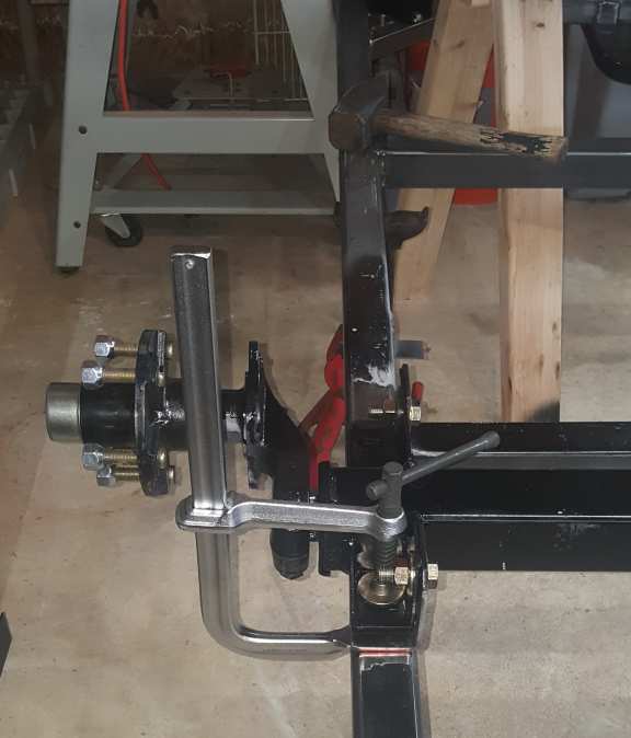

Ready to place the axle. I know that the proper way is to have a finished loaded teardrop, weigh the trailer, check the tongue weight and then you will know if the axle is in the right position for the right weight distribution . But I am completing the frame first then will go on to finishing the rest. I plan to weld brackets to the frame then bolt the axle to the brackets. I have read of people using the 60/40 rule of placing the axle 40% from the rear of the trailer box. I have heard of measuring the box of the trailer which would not include the tongue then for every foot of length move the axle to the rear of center of the box 1 inch. The latter is what I am using as I have had people tell me that worked out for them.
My trailer is a 5'x10' with a 60 inch tongue on which I will put a box of some sort. So I am setting the axle 10 inches to the rear of the center of the trailer frame, again my understanding is you don't measure the tongue. I checked my commercially made motorcycle trailer which is 9 feet long with a 60" tongue and a box on the tongue, using this formula I measured 9 inches back from the center of the trailer box and that is exactly where the axle is and it tows great.
Doing the percentage math on my teardrop frame, 10" back from the center of the box places my axle 41.6% from the rear of the trailer box.
My question for anyone who used this method, either the 60/40 or the 1" to the rear of center for every foot of length of the box, did it work out for you ? If not what did you end up with ? I might be overthinking this but I would hate to have to move my brackets in the end.
