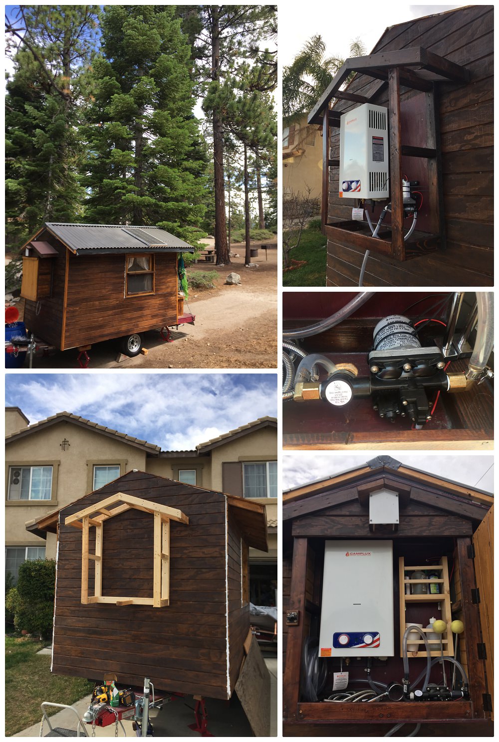

I have a tankless hot water heater setup also. I built a vented box outside of my trailer and ran pex pipes to 4 corners of my trailer with threaded 1/2 male faucets. I I can just hook up a shower hose in any of the faucets and use the hot water. I didn’t want t set it up inside for 2 reasons: carbon monoxide and water leak. The setup I have now solved both of those issues for me.

You can kind of see how it looks outside and inside ...
