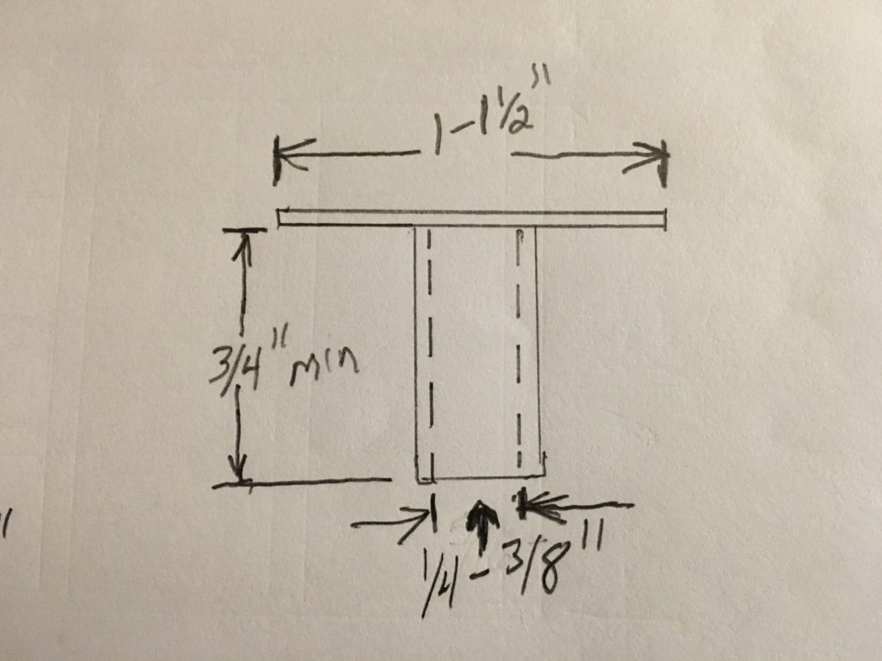

Hello everyone. It's been a while since I've visited this site....BUT, I am getting ready to build a small camper that will fit in the bed of my Ranger. Planning a trip to Alaska in 2021 and going to "rough it"....but having a dry and comfy bed it a must have, hence, this build. I know it's not a teardrop or towable, but I will be using the same basic building techniques and PMF to skin it. I got the main design from a kid that built one on YouTube (Moser Makes).
So, does something like in the pic exist ? I'll be using it to seal a hole in the wood that a threaded knob will go through to hold the side panel to the main body of the camper to help seal it. I'd prefer metal, but plastic may work....it's kinda like a grommet, but will seal the hole. I thought of a coax cable grommet of sorts, but it would be way to small.
Anyone ever seen something like this ??

They are called sex nuts (seriously). Do a google image search. They are metal btw

They are close to what I need, but the hole goes all the way through....I forgot to draw that part :oops: It would be like welding a washer onto a short piece of tubing, which is what I may end up doing if I can't find them.

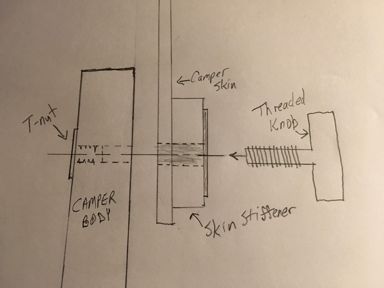

It doesn't need threads. The threaded knob will slip through the "grommet" and screw into a tee nut that is secured on the body of the camper. Maybe this pic will help. The shaded portion is what I'm needing.

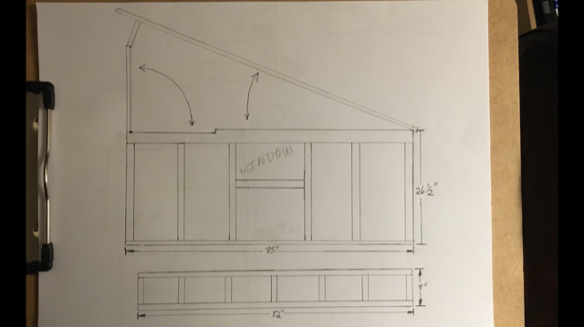

Here is the basic side view of the camper. The "skin" is a pc of 5mm "BB plywood" from Menards. It is triangular in shape and I will add a runner/stiffener (a 1x2) to the skin that runs the length from front to back so I can secure it to the main body of the camper along the "top stringer" in the pic below. I hope this helps explain it better :)

Postby Nodrog » Sat Sep 21, 2019 2:12 am
Hey rinn! Looks like a fun camper. He has 3 videos, did you watch them all? On the 3rd @7 min. in, he talks about the area you are wondering about. Look at it! He is plainly using these screw on T nuts...https://www.amazon.com/Screw-Tee-Nuts-T ... B001DT5KNE . If you have some wood to screw into. There are also small "threaded inserts" available that have threads on the inside and wood screw on the outside. Those would hold pretty well, I think. I believe that something mounted on outside of the skin would keep any water out just fine, instead of using a t nut where the fastener penetrates the wall. When closed the overlap will keep water out, of course.
Check out the third video! The thumbscrews are available in lots of variety on amazon too. Best wishes....Nodrog

Postby Squigie » Sat Sep 21, 2019 9:29 am
I would call that a 'flanged bushing' or 'shouldered sleeve', for lack of a specific term. (Both of which are available from hardware suppliers, but not in the size you desire.)
But...
I don't think you don't need the 'shank' portion for this application, which leaves just a large fender washer remaining.
The amount of 'sealing' being done by the part, as drawn, would be minimal and insufficient, in my opinion. Sealant would still be required. So, why not just use fender washers and sealant, and call it good?

Postby wannabefree » Thu Sep 26, 2019 10:48 pm
2 ideas: When I want something weird, I go to mcmaster.com. If it is made, they have it. The other thought is this would be simple to make; weld or braze a piece of 1/4 inch pipe to a fender washer. You probably don't weld, but there are guys out there just itching for a chance to fire up that 2700 degree torch and burn, I mean melt, some metal.
