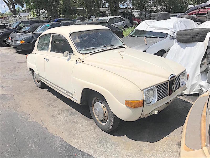

Hi guys , we need to do some thin body metal welding on our new(old) tow vehicle (see pic) … I need to get a small welding machine …Was looking at the less expensive Harbor Freight 110 v units …( Mig ) ..We were wondering if anybody had any experience with these units … ???
