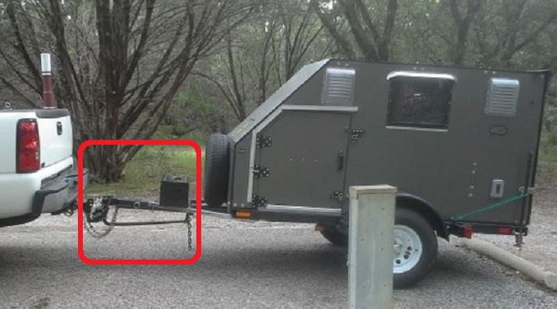

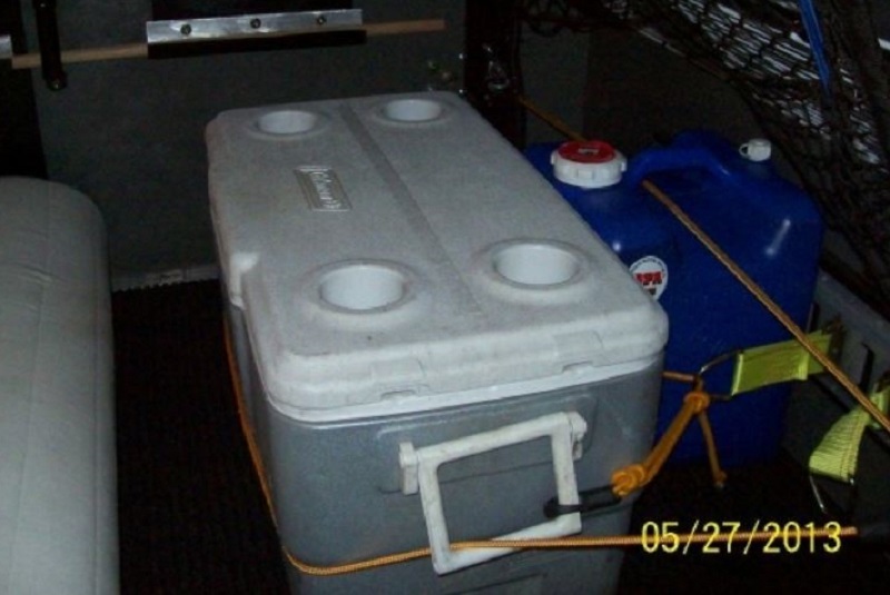

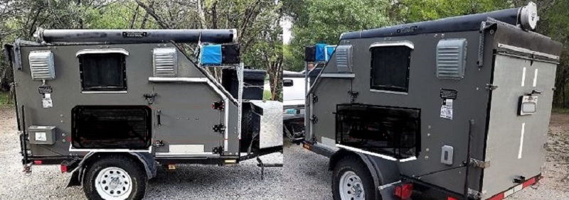

* I failed to mention that my TTT has/had an inherent balance problem, that could've been hazardous to tow at highway speeds, if I wasn't aware of it beforehand. After I stretched my 60" long frame out to 96" (mistakenly adding 12" on front and 24" to the rear, which changed the previous 60/40 fr/rr proportion to 55/45), I knew I'd need some added weight/mass on the tongue to counterbalance it. So, I put the spare tire there, atop the lengthened/strengthened tongue. Using the "trailer balance worksheet", I started to add my necessary equipment in the galley/storage area, but doing so, the worksheet showed that my tongue weight fell to zero lbs. Obviously, I'd need more changes to increase tongue weight before travel.
* Moved the battery into a small toolbox I had mounted to the tongue, as an interim solution until a properly-sized box could be found. Then fabricated a piece to be able to use a single spring-bar from my larger trailer's Weight Distributing hitch, to pull the nose-high TTT tongue down, and achieve effective balance, with the still light tongue weight-total weight ratio of 7%. To increase that weight, I strapped a cooler and 1 or 2 Aquatainers to an E-track I had previously installed on the front cabin wall (my TT is registered as a cargo/utility trailer, afterall), adding enough forward weight to change the apparent tw ratio to 10-11%. That worked until I found a larger box for the front.
* Always adding more gear, and trying to make camping set-up and loading/unloading easier, I also modified my towing arrangement as the weight balance "forward movement program" progressed. I finally eliminated the need for hauling my water/cooler inside the cabin, and also levelled the nose-high condition of the tongue (with a drop-shank). With the tongue weight now over 260 lbs (scaled) and the trailer weight now at 2200 lbs (estimated), the tw ratio is about 11-12%. At that ratio, and having levelled the stance of the trailer, using my WD spring-bar is no longer a necessity. I'll only use it on long trips, or where I know I'll have a drive-thru spot reserved (it's a bear to install/remove, requiring two jacks).
* That's the story of a planned-to-be lightweight trailer morphing into a neutronium-weight TTT, first spurred-on by the desire to make it tow well, despite errors in construction and additional gear accumulation. It could happen to you! (a tale for Halloween)

increasing tongue weight, by using 1 or 2 Aquatainers, and large cooler strapped to front wall E-track.JPG
increasing tongue weight, by using 1 or 2 Aquatainers, and large cooler strapped to front wall E-track.JPG (99.46 KiB) Viewed 2597 times
level trailer with final storage box solution.JPG (113.98 KiB) Viewed 2597 times
