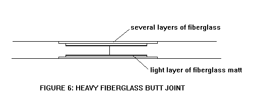

Postby swoody126 » Wed Dec 11, 2019 7:56 am
NB, the process is quite simple
we use it when butt joining pieces of plywood together to create longer ones for boat building
first of all you use TL's suggestion(since you don't have it on a flat horizontal surface) and screw a piece of plywood behind the joint(wax'd papered of course) to hold the pieces in place while working
then do one side at a time
hollow out the butted edges to accept the FG matte & cloth using an angle grinder
appy FG and allow to cure
once cured take your plywood backer and using the same screw holes and the other side of the plywood wax'd paper covered repeat the process on the other side of your joint
fill the screw holes w/ thickened epoxy
once cured and faired your joint will be something like this
plyjnt6 2.gif (1.57 KiB) Viewed 835 times
it aint rocket surgery
i've done it w/ my Midde School students many times joining 1/4" plywood when building flat bottomed pywood canoes
BON CHANCE
sw
