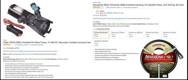

working on it wrote: We recently had to live in our 20-ft travel trailer, in the rear driveway/parking area, for three months last fall. Our house needed replacing, so we lived there with our numerous dogs & 2 pet birds. viewtopic.php?f=2&t=69239&hilit=neglected We used two Rhino flex hoses (20+ feet) to disperse our graywater onto our backyard, but our blackwater disposal presented a problem.
We have two septic tanks on our property, but the nearest access port (tank lid) is 48.5' away from the wastewater valve assembly, and uphill, so we couldn't use gravity to empty the BW tank. So, I bought a Flo-jet RV waste pump w/macerator, and a large diameter 50' hose. I also installed a clear extension onto the valve assembly, so I could observe the flow, and a city-water hose (75', from my neighbor's house, on a separate fitting than to the trailer itself) to flush the tank/macerator clean.
The system worked flawlessly, and I used it every 9-10 days. Sure beat having to use a rolling disposal tank, IMHO. I used my HHR's battery as the 12vdc source, since it was parked next to the trailer, and never had any problem at all, until I buried the septic tanks again, after the plumbing of the new house was done, and I had to empty the BW tank a last time before winterizing it (a hard-cold front was coming that night). My new septic-tank-access port was 7 feet further away, so I bought a cheap, 5/8" diameter 10' hose from Lowe's, to span the distance. That hose kinked up, built up pressure, then exploded, scattering waste all over the yard. Fortunately, none on me, or the house, but only over a part of the dog yard, before I could fix it. Using a better hose, I successfully emptied the tank, sanitized equipment and the access port, and then winterized the trailer. Nature (and strong rains) sanitized the yard, that week.
* I used a hose-splitter connected at the spigot, to separate the flush hoses from the drinking water source hoses, and another cut-off in between the two flush hoses (both turned off after flushing). I hoped to avoid any possible backflow in that manner. The flush hose end that connected to the Flo Jet was rinsed in bleach water, as was the Flo Jet itself, after each use, and both were removed from the trailer outlet, so the usually "always open" grey water pipe could be utilized (the trailer was used for three full months, with the grey water draining into the former "goat pen" portion of our backyard. My wife and I never got ill, so I presume we avoided cross-contamination successfully.
pump and hose used for trailer waste disposal.JPG (42.13 KiB) Viewed 858 times
