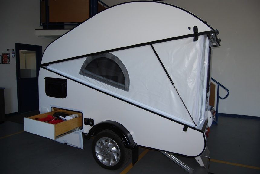

To keep as light as possible. think clamshell .can keep main body lower. no doors , tent style windows & door You can stand up to dress . If raining can set up table and be dry. If using fiberglass over foam Don't buy in to the epoxy BS .Just use the right 1/2 foam
lift top.jpg (182.7 KiB) Viewed 1482 times
