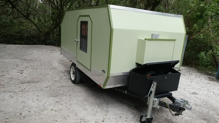

Thanks for all the suggestions. We're moving about as cross country as it gets -- Tampa, FL to Olympia, WA. We've only used the camper for little trips and we're just paranoid about those tiny harbor freight wheels.
Love the idea of buying a utility trailer -- the camper is about 800 pounds so it should work -- but I"m not seeing any for less than $1100. But I would definitely love the excuse to get one.
I'd love to update the axle/tires even more, but I've only got a couple of weeks and not something I'd be able do. And the way the camper is built, I don't think I have the clearance for bigger wheels unless there's some method of lowering the axle in the process. Don't have a great picture, but here's one that sort of gives the idea of the way the wheels are situated.

I upgraded my 4.88/12 to 5.30's. It's a size taller and wider. Seems to help keep the bearings alot cooler.
Just a idea for a future upgrade.
Just make sure to strap that trailer down good inside the other trailer. Dont want it moving around.
