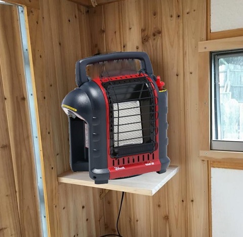

Postby eLink » Mon Jan 27, 2020 7:33 pm
I have used a Mr. Heater for van camping (with window cracked). The small propane tanks last only 6 hours though.
Looks like it will fit on your shelf!

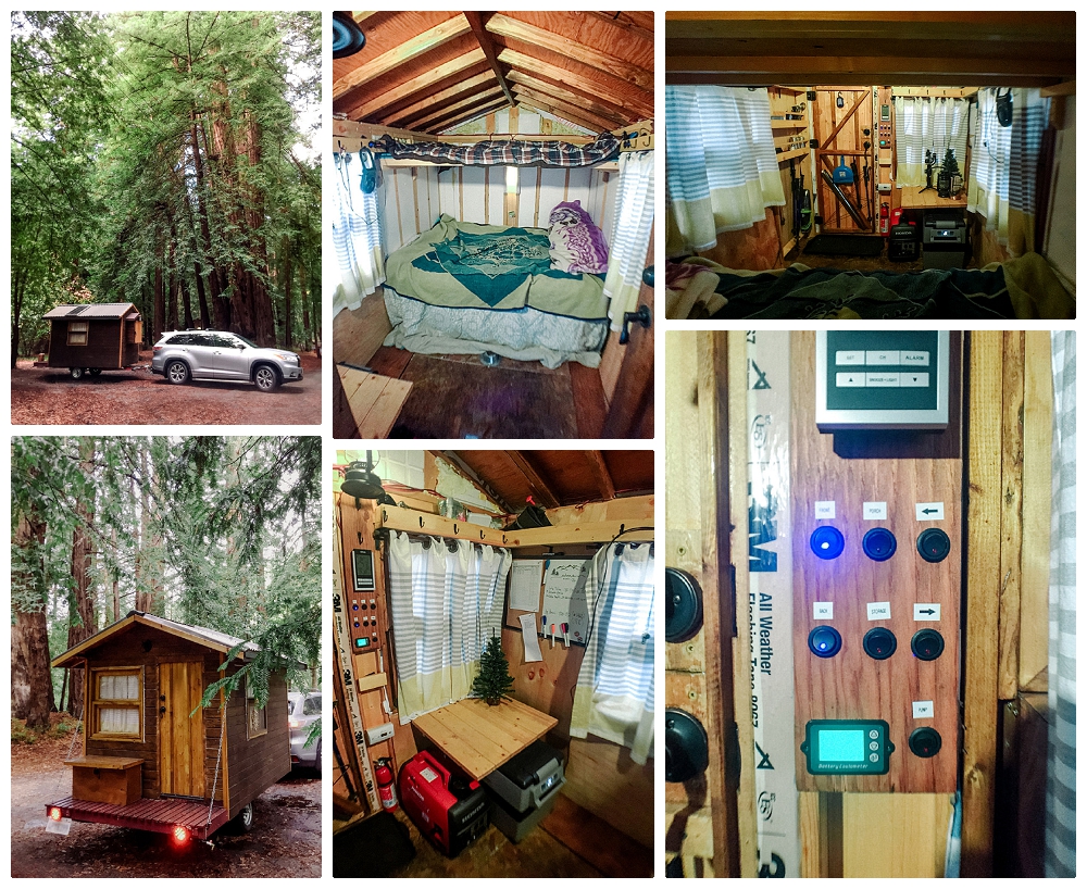

Postby Vtec44 » Mon Jan 27, 2020 8:08 pm
My trailer is fully insulated all around with R10 foam. The roof isn't insulated inside but it is on the outside under the polycarbonate roof. I have a vent hole toward the front of the trailer with 2 12v DC fans that will provide some air circulation when necessary. In addition, I have a Mr Buddy Heater and a carbon monoxide detector. I've camped in 30 degrees weather where the inside of the trailer remained in the high 50's without using the heater all night. I generally turn it on at the beginning of the night before I go to sleep. It gets up to the mid 70's quickly. I turn it off before I go to bed and only turn it on again if it gets too cold. I have plenty of standard blankets and a 0-degree sleeping back as an emergency if it gets too cold. So far it has been working very well for me.
So my strategy:
- 2" R10 foam insulation all around
- Air vent with fans for air circulation if necessary
- Mr Buddy Heater and carbon monoxide detector
- Thick blankets
- 0 degree sleeping bag as emergency.
160826

Postby Modstock » Mon Jan 27, 2020 8:15 pm
I use a heater buddy. Little bit smaller than pic above.
I usually only run it about 10-15 minutes before bed. In a 4x8 teardrop it gets warm quickly.
With a -5° bag also, once im warm I can sleep all night.
And both windows cracked about a 1/2" OR more.
I tend to keep the roof vent closed to keep heat in.
One warning I'd give is, be careful about how hot the ceiling gets in small spaces.

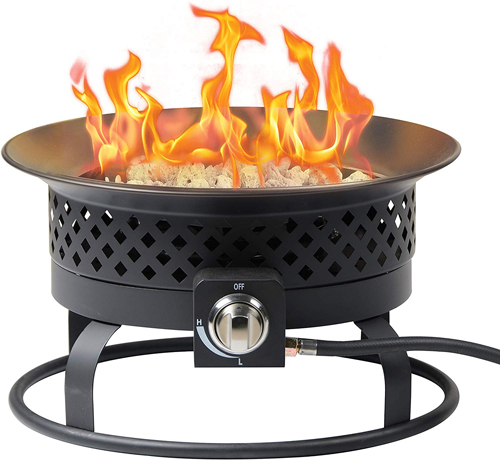

Oh I had the same issue on my last camping trip. It was in the low 20's which wasn't bad, but my hands were frozen! LOL So I bought this thing on Amazon and a grill to put on top of it. It's basically a fire place which will radiate heat while I'm cooking on top of it outside :D
https://www.amazon.com/gp/product/B01HT ... UTF8&psc=1

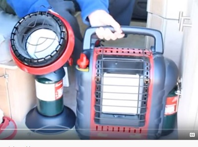

Postby eLink » Mon Jan 27, 2020 11:06 pm
lfhoward wrote:Has anyone used the small version, the “Little Buddy”?
Oddly enough, the Little Buddy is actually a bit taller and the heating element sits higher. They both get hot directly above so they cannot be placed too close to the ceiling. They Need 30" of clearance or so.
https://youtu.be/OWTCRaBGb6M
