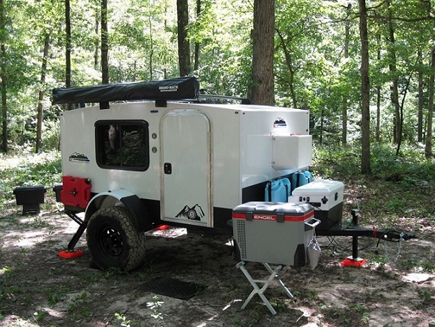

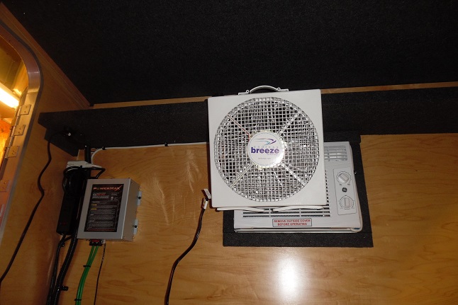

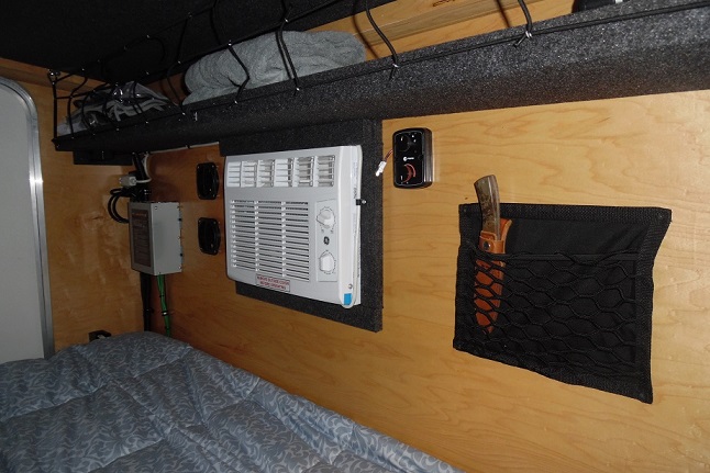

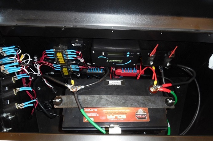

12v. gear we have the following: Engel 40 qt 12v.\110 portable fridge\freezer power consumption 0.7 to 2.5 amps, Endless Breeze Fan 12v.power consumption is 1.2 amps on low, 1.6 amps on medium speed & 2.6 on high speed, AT Overland Forced Air Heater (Proplex H2000) 12v. pulls 1.4 amps\Propane. I own a few 12v. gear for camping, all are low draw\consumption.
When I was wiring our squaredrop for 12v.& the gear we use is what is important to know type of power source (battery\batteries), overcurrent protection (fuses\breakers), return path (ground), wire size, conductors to distribute the current (bus bars, relays), the load of the appliance use. Not all 12v. appliances are the same in power consumption & quality. "For me & the wife" we purchase the lowest power draw consumption appliances we can find, saves on battery life, usually these items are quality & are long lasting.

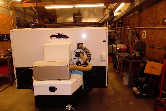

I use some thing like what you have, built by AT Overland, portable forced air heating uses the Proplex H2000

I use some thing like what you have...
Same heater. :thumbsup:
