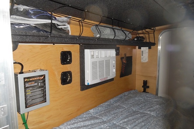

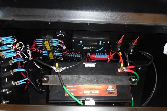

Postby ArkansasDon » Mon Feb 17, 2020 7:23 am
if your going to up grade, research what will give you the best out come to run your 12v. equipment \ gear. When I was doing the electrical on my current trailer "for me" battery capacity (AH) amp hours was important, I wanted a battery that can withstand cold weather the capacity & performance is not reduced by low temperatures whether cold weather camping or storage. I wanted a battery that will give me years of use, I went with a AGM type battery, VMax Tank AGM 125ah.
Charging was another important factor "for me" to keep my battery full charged & I wanted 2 sources of charging. Solar was one & in my 1st post I went with Renogy & was happy with them on my 1st trailer build. I went with the exact same set-up on my current trailer, 100 watt Renogy Monocrystalline folding solar panel (suit case type), 30 amp Renogy Adventurer Charge Controller w\ battery temperature scensor, 15ft of 10 awg cable. I like the Monocrystalline panels because of their ability to give excellent performance in low light environments. I like the option to move my panel to follow the sun than having a stantionary mounted panel.
My tongue box on the front of my trailer holds most of my electrical, houses my solar charge controller (keeping it weatherproof), I installed a solar shut switch to shut down my solar completely since the charge controller can draw power continuously because it is connected to the battery. I have another shut switch for 12v. power separate so I can shut the entire electrical down while storing the trailer when not in use.
My 2nd source of charging is 55amp Powermax Converter Charger which is integrated 3-stage 110V ac power to 12V dc power to charge a battery or power 12V equipment. The 3 stage modes offer 13.2 Vdc range "float" mode, 13.6 Vdc range "absorption" mode, & 14.4 Vdc range "bulk" mode the converter charger will automatically choose the mode to maintain the battery depending the battery's condition of charge needed. Otherwise fast charge, normal charging & trickle charge explaining this in English. This can be connected to shoreline power 110 or inverter generator. It will not over charge. I have a system I can use in sun or heavy overcast days w\o sun & still have the ability to maintain charge to my battery w\o hindering our use of 12v. equipment.
