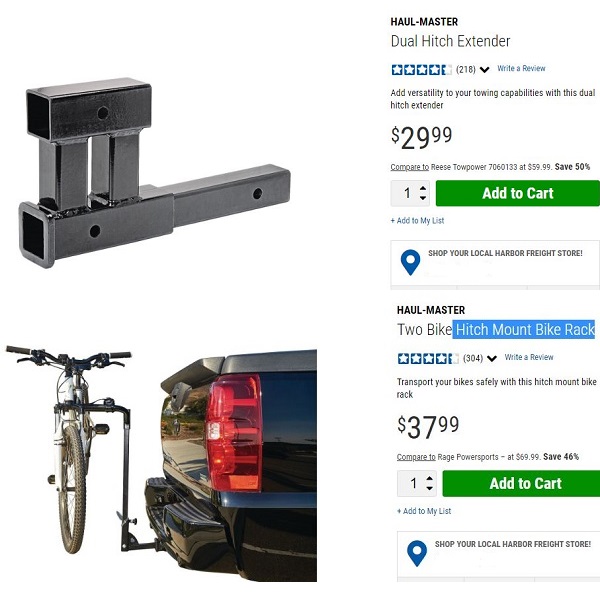

Postby working on it » Wed Feb 19, 2020 8:53 am
inexpensive bike hauler mod.jpg (91.13 KiB) Viewed 4847 times
* I was considering these, before I tried biking on one trip...my knees are so bad, I've never used the bike again (now, I normally wear one hinged knee brace, sometimes two, just to be able to rise out of a chair).
173193172890148599

Postby mary and bob » Wed Feb 19, 2020 9:30 am
Those double hitch extenders are heavy (I have one, used it once) and according to specs on some they reduce the capacity of your vehicles receiver by 50%. Probably not an issue with a light trailer. They will prevent the truck tailgate from being opened with the bike on. I've tried a few ways of carrying bikes, on the rear of a trailer, which will affect tongue weight and possibly cause sway. You need a rack rated for rear use on a RV (most are not), I had one rear mounted rack bend with two bikes on it. I tried a rack mounted on the tongue of our teardrop and that worked fairly well but did affect turning radius. Now our tow vehicle is a full size pickup with a 6 1/2 foot box and a cab height cap. We use bikes with quick release front wheels so I have two fork clamps bolted to a piece of plywood in the pickup bed and the bikes ride standing up and out of the weather. Best solution for us. Tried riding a folding bike, but didn't like the way it handled with the small wheels.

Postby Tomterrific » Wed Feb 19, 2020 9:46 am
The hitch extender might work okay for us. We have two 1 1/4" hitch mount bike racks. It will be a pain to get into the bed. The tailgate must be dropped before the cover can be unlatched.
