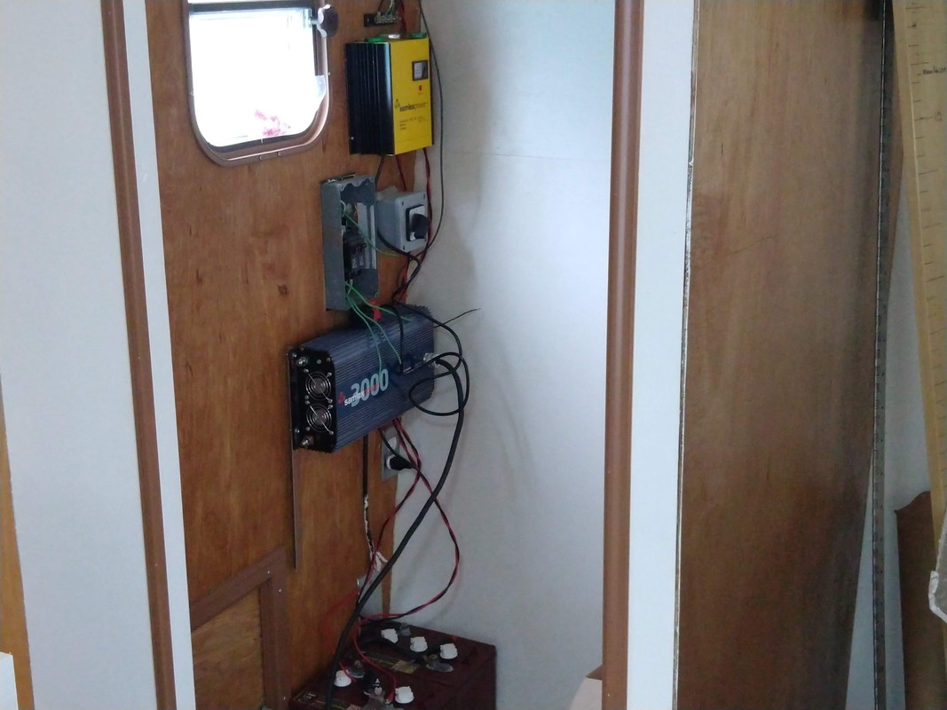

Postby S. Heisley » Tue Apr 07, 2020 2:11 pm
:thinking: If this is any help, I have my battery behind my toilet, separated with a closed but not sealed tight compartment and the electrical connections and controller are directly above. The battery is in a special sealed battery box that is vented to the outside, but the Luggable Loo toilet bucket is not vented. However, my battery is an AGM. (You don't have to vent an AGM but I did it just in case anyone ever used a different type. I've found that even AGM batteries out-gas a little.)
It's been that way for 9 years with no problems. (My battery is finally wearing out after 9 years!) You can see most of it here, including the white outside hose that connects to the top of the battery box:
gallery/image_page.php?album_id=1291&image_id=67321
Here is the completed project, set up for that midnight need. (The battery is in the compartment behind the toilet lid.):
gallery/image_page.php?album_id=1291&image_id=99101
Note: I can't get the image thingy to work, but if you click on the addresses above, you'll be able to see the pictures.
