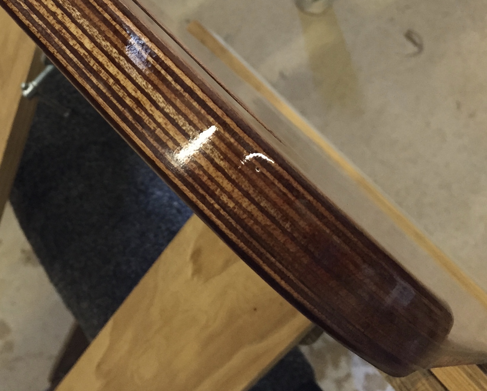

Postby MatBirch » Thu Apr 09, 2020 12:11 am
I used titebond 2 for my PMF over Luaun ply. I had a similar problem in a couple spots but they are very small. For yours, I would try to find a syringe and inject a little TB2 into it. Let it dry for a couple of days, then hit it with an iron. It will melt the glue,and you’ll be able to press it back flat. Piece of parchment paper will keep your iron clean and won’t affect adhesion of the next coat.
Or... you can trim it out with some strategically placed twill tape as trim

Re: PMF question...ever had this happen?
Postby GPW » Fri Apr 10, 2020 4:07 am
Pat , Good fix !!! :thumbsup:
Postby Patrio » Fri Apr 10, 2020 10:17 am
Just finished the third coat. Looking good!
This pic "hides" it a bit. It's still visible, but not noticeable at all. I'm happy with it.
