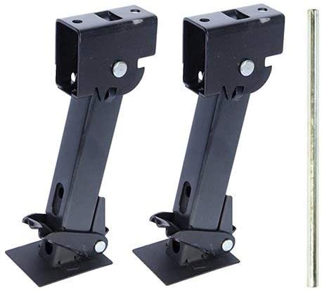

I have a used set of 4 of these guys that I originally installed on my wife’s cupcake trailer. They did ok, but she really needed the ability to lift and adjust to account for uneven terrain quickly and in place, no jockeying... I replaced them with large scissor jacks.
Anyway, curious for opinions of just using these, VS a diy “Valterra” type setup? The Valterra seems quick and easy, easier to build a set or two, than crawling around under the trailer, grinding undercoat and paint, and then fabbing up brackets for the metal ones.
Thoughts? Experiences?

The telescoping Atwood jacks are the worst IMHO. They get stuck a lot and they pinch like the dickens. I switched to BAL jacks and they're much better. They don't pinch and they're more stable.

I agree with Bruce about telescoping jacks. I also do not like crawling under trailer to swing them out. So overall I do not like the design and fiddling with it and I am also looking for alternatives and BAL design looks like a better one, but not sure how to switch from telescoping to BAL.
Bruce, did you have telescoping ones and switched to BAL? Will I need to weld more steel members to frame or can I re-use the same gussets I already have from these telescoping jacks?
BTW, there are a lot of videos about low cost solution with two 2x4s positioned at ~45 degree angle a ratchet strap under the camper between them which is basically a homemade version of Valterra stabilizer. I might give it a try and see how it works as an alternative to telescoping jacks. They look something like this (image is from trailerlife.com website):

I made 2 sets of these DIY ~45 degree 2x4s with ratchet straps stabilisers I mentioned above and they work GREAT, a way better than my telescoping stabilisers. The trailer is basically rock solid when 2 sets are setup. I think I will use them instead of the telescoping stabilisers I already have because they just work and actually are easier to setup.
