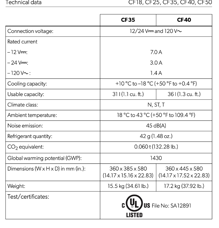

Below is data from Dometic web page:
CF35 1.1 cu ft, 31 litres
Max 7amp
Max 109 deg F
Min 50 deg F
34.6 lb
Dometic specs.png (122.12 KiB) Viewed 1311 times

The dometic numbers above are accurate but they are measured when the fridge compressor is running continuously. Once the fridge is at the desired temp the thermostat shuts off the compressor and energy consumption drops to a few watts to keep the temp monitoring alive (same as home fridge). For our purposes you might consider a measurement that factors in run time duty cycle and the rest time in between compressor runs. Over an hour the fridge may run for less than 15 or 20 min depending on a lot of factors such as ambient heat etc. Other data appreciated

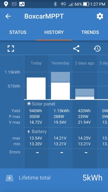

Here's the total energy use from last week, I was running an upright fridge in the trailer and the CF-40 in the truck bed. Its a screen shot from the Victron phone app, which has all kinds of awesome data it can display:

Looks like you are getting 4.3 amps an hour or about 51 watts for the CFX-40. I am measuring 3.6 amps an hour or 44 watts (pretty close to you) with the CFX-35.
With a 120 amp hour AGM battery I squeezed 131 amps out of the battery which ran my fridge 36 hours. That took the AGM down to 10.5 volts in my case. Something I don’t usually do. On the shortest days the solar panels can not generate for about 15 hours of darkness.
When camping for several days I am on solar. I carry (3) 100 watt panels here in the east for tree shade and cloud combinations. I have a 4th 100 watt panel I can put in service if conditions are bad enough.
On the short days In the dead of winter (when I need AGM) I need sun in the morning and once I get it I can top off the battery. In horrible conditions it might take all day to top off the battery in my. Success so far.
If the magic wand was working I would use AGM in the dead of winter and Lithium the rest of the year.
=Cosmo

The peak power I saw was 310w from a 420w array laying flat on the roof. That's something to remember when you're trying to figure out how much PV you need - you won't get but 75% of what the panel is rated for in real life so plan accordingly. At minimum you should buy a PV controller that's at least 25 or 50% larger than what you think you'll need so you can expand your array down the road with out too much trouble.
