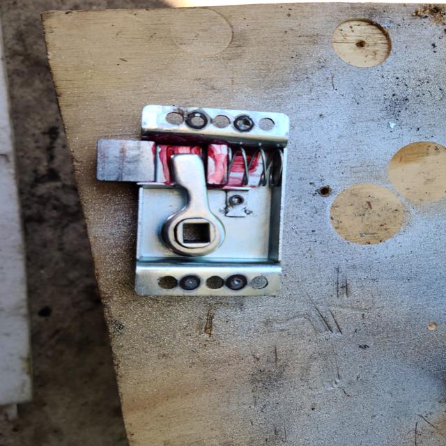

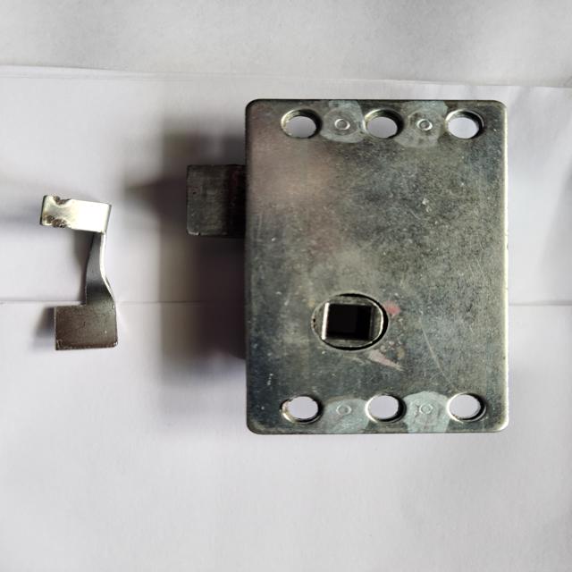

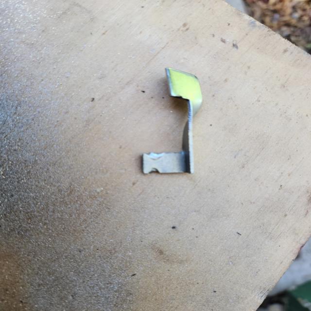

Has anyone had a T-Handle Slam Latch break? Allow me to explain:
I use two of these to secure my hatch. I always turn the handle to retract the latch(I don't slam them) to close. This weekend, I went to open the galley and one of the latches would not retract. After fighting with it, I did get the hatch open.
I found a metal piece that must have broken free internally stuck hanging out by the latch.(Pic enclosed)
2nd question: I only secure my galley hatch with two of these latches and I am now concerned with them failing and the hatch opening on the road. Is this just a one off or should I consider using another latching system??
Thanks for any help!!
John

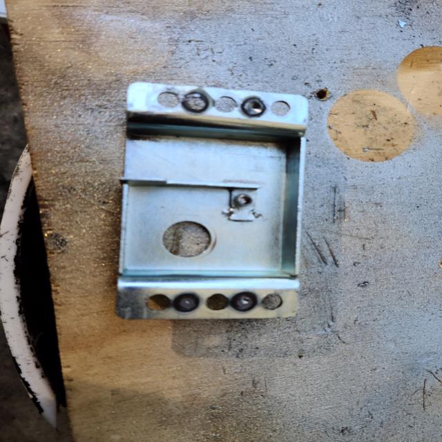

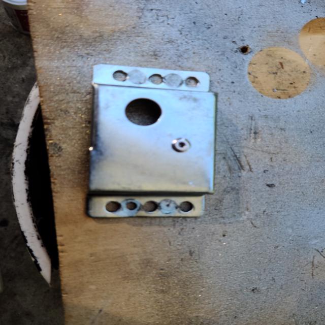

Re: Broken Galley Slam Latch-REPAIR!
Postby Minics04 » Tue Jul 07, 2020 9:13 am

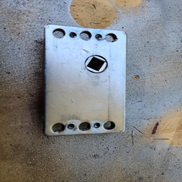

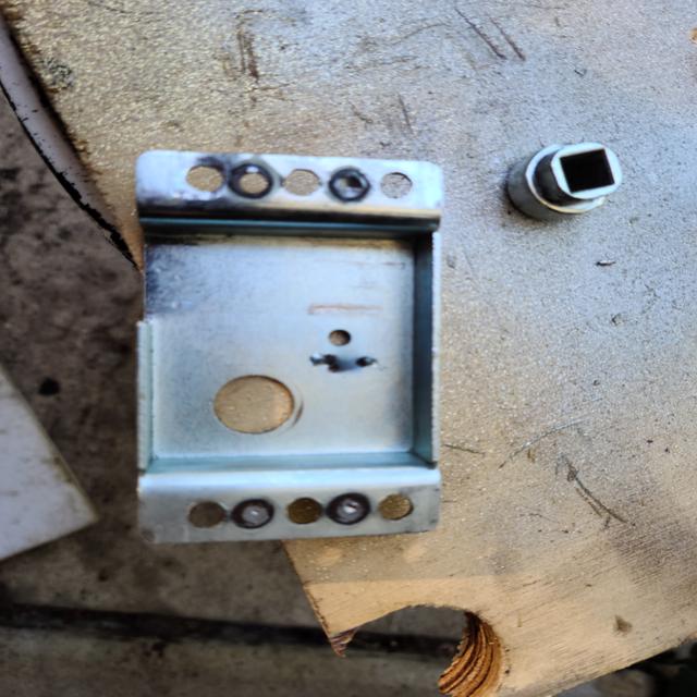

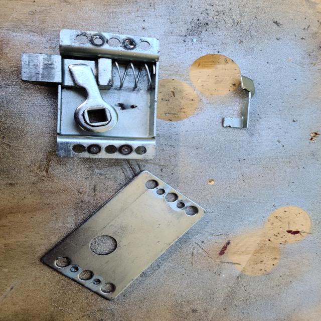

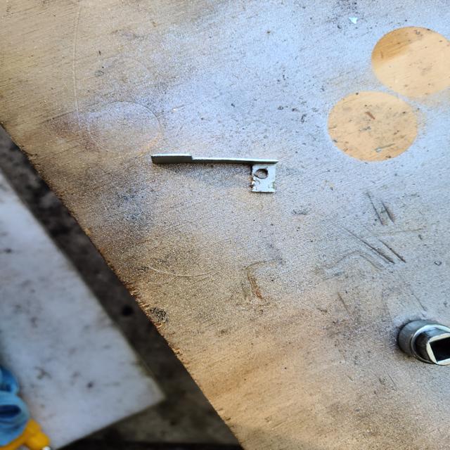

Did a little work on the latch and it is repaired.
Offending Broken spot welds on piece
Drilled Out Spot welds
Inside
Postby Minics04 » Tue Jul 07, 2020 9:15 am
Would only allow 3 attachments.

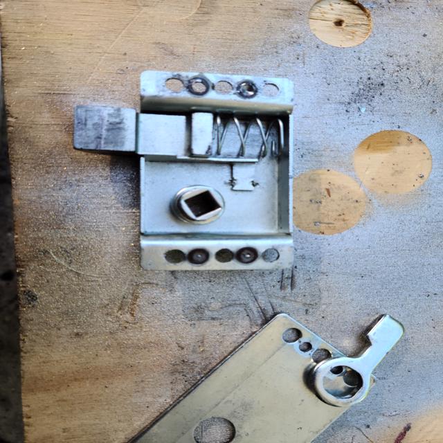

Postby Minics04 » Tue Jul 07, 2020 9:17 am
Last Pics
