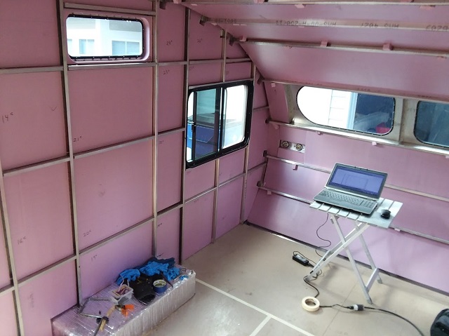

1.5" insulation board

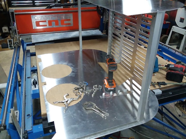

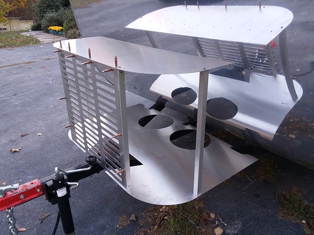

Heat Pump "doghouse" under construction
The holes on the bottom are for 12 volt condenser fans. This draws cooler air from the underside of the camper and feeds the condenser.

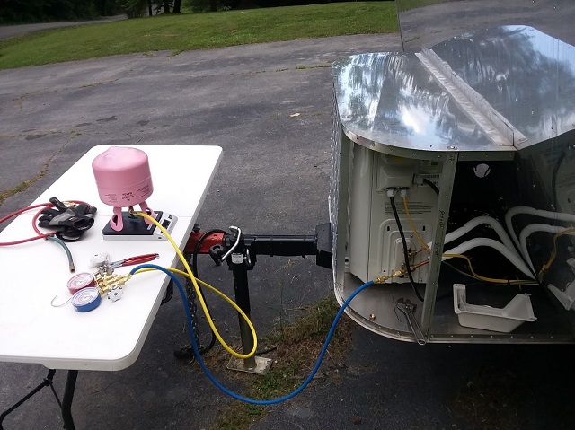

Charging the mini split. Normally the service covers are installed hiding the unit. So far even at 95 degrees the camper stays completely cool.

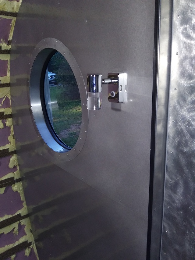

Interior skins are natural aluminum buffed with scotch brite and vinegar (breaks down any oxidation) and sealed with Sharkhide metal protectant.

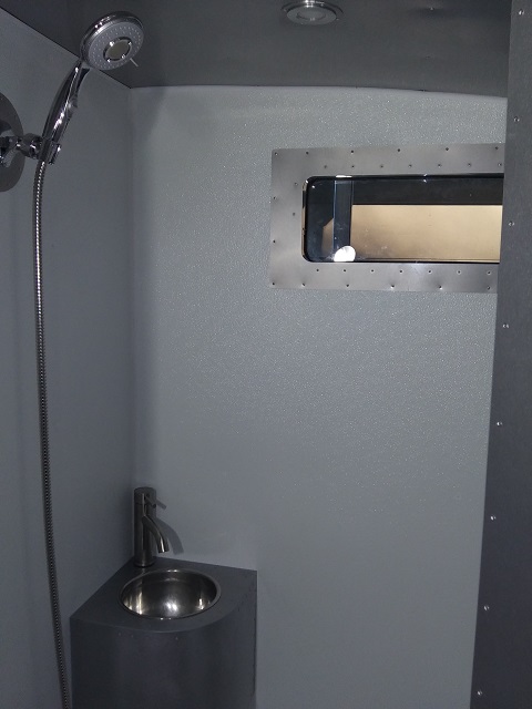

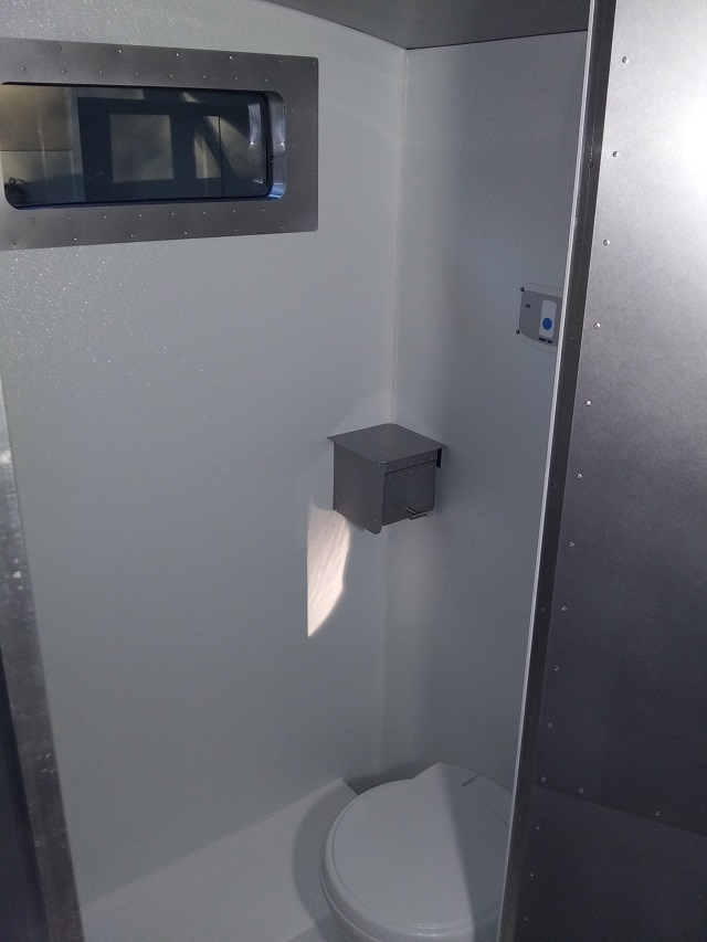

Wet-Bath. The object near the toilet is a shower proof toilet paper dispenser.

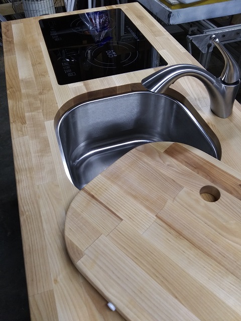

The corner sink "Bowl" is actually a salad bowl purchased from Kohl's
Galley under construction, still in shop waiting for drawers and faces. The camper is all electric
so cooking will be accomplished with an induction cook-top.
