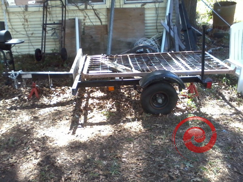

* My trailer was pure junk after sitting in the "swampy" area behind the backyard for 18 years. I had dragged it home from a swap meet where I had gotten it for $50, with only a bill of sale for documentation, and no tags. It came as no surprise to me that it had burnt out both wheel bearings during the 50 mile trip home. It had 8" wheels and a cracked/bent tongue, and only a 48" x 60" piece of holy plywood as decking. I sorta rebuilt it to give to a nephew to haul stuff at the ranch, but he declined the offer.
starting point, day one ... twin bed frame shown for size comparison

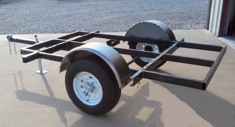

* So, it sat behind a shed for nearly 2 decades, and even the treated plywood and lumber I had attached (to make it usable) had mostly rotted away, too. Then came the day I took it to my friend's garage/shop/hotrodders' hangout, and started transforming it to a teardrop/squareback camper (I transported it there on my 18' car-hauler, as the 8" tires had rotted away, also).
a lot was changed prior to this picture
extensions added.jpg (111.82 KiB) Viewed 3095 times

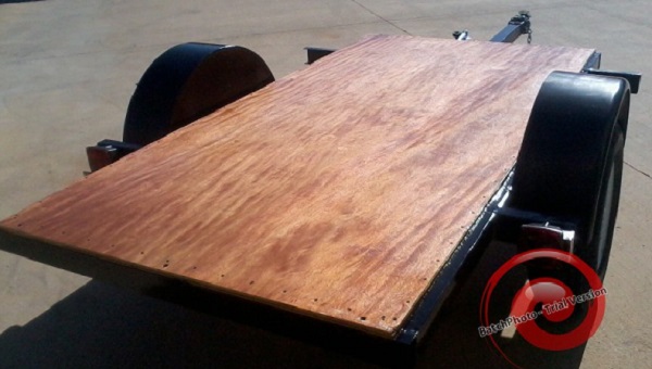

* After a lot of welding to make the 50"x 60" frame into 50"x 96", changing the hubs/bearings/wheels to a much better 14", adding a proper deck (3/4" thick, sealed and polyurethaned), and installing 3" square tubing as a replacement tongue, I went to the DMV to register it as an "utility trailer", so I could legally go weigh it (400 lbs, up from , 200 when first bought), without avoiding the police)...I had previously registered it just after I brought it home, but having torched off the VIN sticker when installing the new tongue, I registered it anew, as homebuilt.
ready to use as 400 lb utility trailer
* Registration in Texas is easy, and since the trailer is under 4000 lbs, has no plumbing onboard, and still carries "cargo", the trailer retains a utility tag to this day (now much-altered/improved and 2200+ lbs). Depending where you live, how you intend to use it, and when you need to take it on the road,... all might affect your registration plans.
