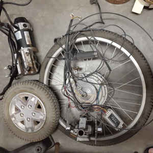

Postby Pmullen503 » Fri Sep 04, 2020 6:22 am
[US$87.11 23% OFF]24V 250W Electric Bike Conversion Scooter Motor Controller Kit Fit For 20-28inch Ordinary Bike Other Vehicle Parts & Accessories from Automobiles & Motorcycles on banggood
https://banggood.app.link/HQpNw0Apv9
Above is a link to an e-bike kit that uses a separate gear motor to drive the wheel. Combine that with your bike parts and all you need is the cart itself.

I realized a bit too late that my axle mount was upside down.. :shock: I want to add a couple cross pieces so still okay to easily flip them. The axle mount I sleeved a section of 3/4" sch40 inside the the 1" shed 40 making the axle mount 3 layers thick, that should work.. :thinking:
With the axle flipped and the extra cross pieces, that should handle the cooler, chairs, sun shield and rods/tackle. Hopefully..
The handle is glued at the top and will place pins at the bottom so the handle is removable for transport. The uprights I see as 4 more 3 ways at the top making a cage/rim of sorts and not glueing into the base frame. Again removable for transport. Gears on the tire rim need to go on the inside if I wish to power this in anyway.
I'm heading out fishing tomorrow and the cart is not ready.. bumma.. Any who, that's where I'm at! :beer:
