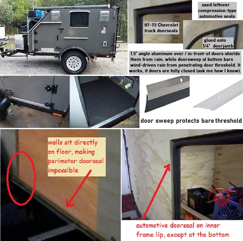

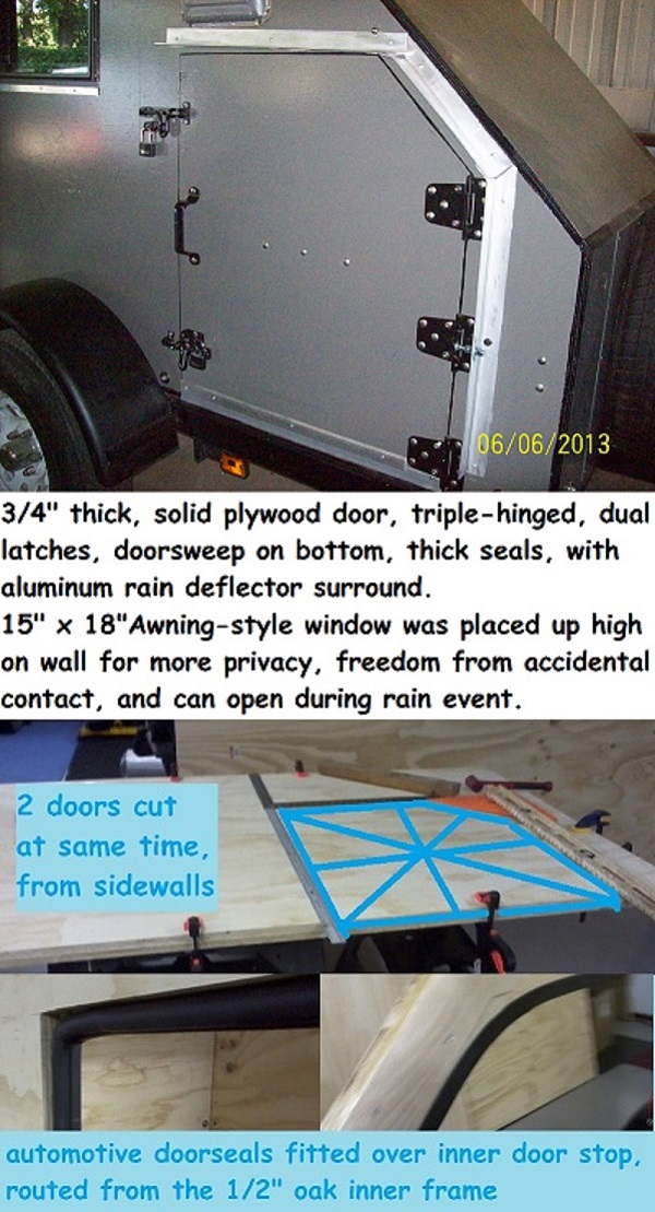

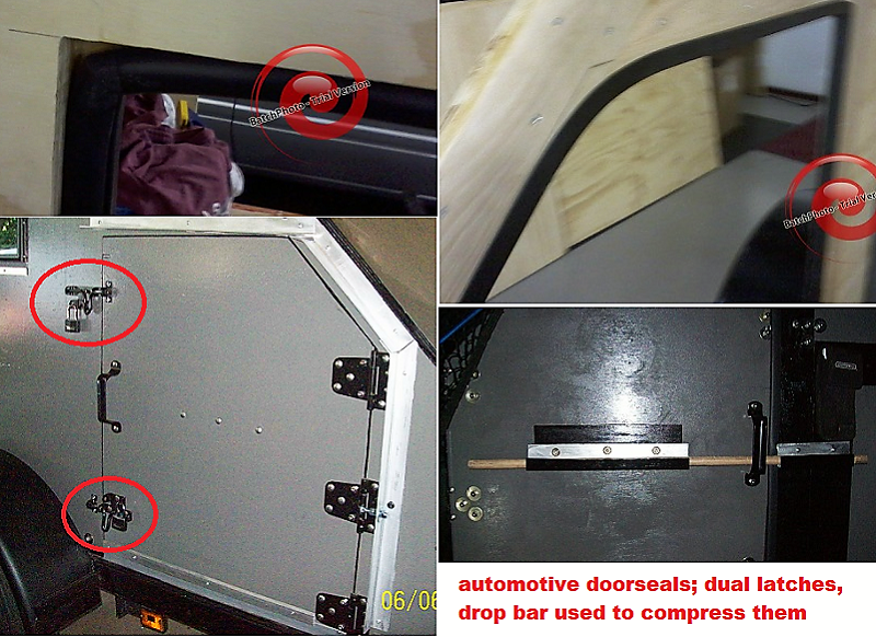

* My camper started out to be a "no/low budget" build, using whatever I could readily find locally, or re-purpose from parts on hand from other projects. I also decided to build it as a simple, angular squareback, using only straight cuts, and thick 3/4" plywood (with no insulation), so it would be very strong and easier? to construct. Certain design decisions I made (45 degree front sloped roofline, and a forward-of-normal door placement) made making my own doors a necessary choice. I cut them out from the sides, and used a method similar to Tony's, to seal them.
* As for using no windows in the doors: I enter the trailer headfirst, with my feet at the door end side, so windows there would've been subject to accidental contact, and possible breakage. And, I wanted awning-style windows placed up high (for more privacy, and security), so none could fit into the doors anyway. I tried making scale-model Wiley windows, but didn't like the way they worked, or looked, and finally bought the awning-style windows I had bookmarked as my first choice, 2 years before I bought them (the windows were bought/installed after the rest was 99% already finished). Here's the way I made and installed the doors and parts I used.
working on it wrote: from another thread I used compression-type automotive doorseals, that I had leftover from restoring my old '69 Chevy C-10 pickup (I wish I still had it) in the late '90's. The seals are mounted on the 1/4" inner doorjambs of the oak bracing surrounding the solid 3/4" plywood doors (totally sealed with "the mix", and multiple coats of poly and paint), and the bottomside has an exterior doorsweep hanging down as a drip-edge, protecting the aluminum threshold there (no rubber seal there, just a wood/aluminum interface).
* Another thing about using those leftover seals from my truck restoration: they were really too thick to let the doors compress them and still remain flush with the sides, so I used scissors and cut about 1/4" width strips from the bulbs, nearest to the inner doorjamb, so they would still have plenty of rubber there, and fully compress. I nearly bought different ones, but the molded corners of the "factory-style" '67-72 Chevy C-10 door seals fit so nicely into the corners, that a little work on them was worth the effort.

aggie79 wrote:I echo what Tony said. Building your own is 1) expensive, 2) a lot of work, and time-consuming. The upside is that you get the design you want. The downsides are that self-made doors can be 3) hard to fit, 4) can be prone to warping if not constructed correctly, and can be 5) hard to seal/weatherproof.
* Though not typical of most doors in teardrops or squaredrops, due to shape, position, and simple/solid nature, my 3/4" thick, window-less, plywood "cut-out" doors were:
1) inexpensive (using what would've been scrap plywood, instead),
2) not a lot of work nor time-consuming,
3) not hard to fit (sanded 1/8" more off the edges, to enable flush closing...extra-thick seals were also trimmed for same reason),
4) maybe, a little, (but, it was because one door became slightly warped, before sealing with polyurethane & paint, due to "someone, not me" moving the door from flat, dry storage to standing it up vertically near an open garage door during a rainy week),
5) not hard to seal, if seals conform to door shape and are securely attached (and doors fully closed...ask me how I discovered the necessity).
* If I were to build it over again, for the same reason (my wife's security during solo camping)... examples to wit: I chose 3/4" plywood for the exterior as secure against most damage, used small windows placed higher-up on the structure, and employed multiple strong hinges and modified/custom locking devices, nothing would be changed. However, built for my personal use (as it turned out to be), tony.latham's or aggie79's doors would be preferable.

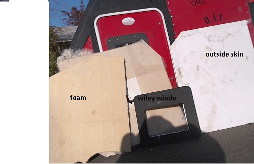

foam under glass is the easiest way to build any shape no BS t are p molding to buy are fight. If you get a leak. So what can not rot swell up. 3 steps make skin cut foam cover inside with glass . We do door blanks with willy windows for $30 are so by having window lower in the door helps with colder air coming a cross your face
