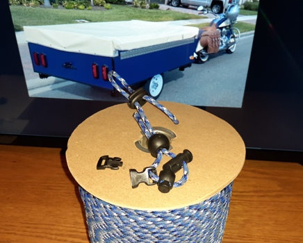

I waited all day for the UPS man :lol: ; Here is 1000 ft of para cord and all the clamps / clips I could find came too, had a pair of shoes and thought these would work like the dawg was explaining for my boat cover, but these slide way to easy to hold that load, but the two piece snap clips should hold.

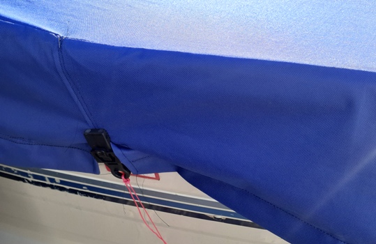

Pic of my top with a long term temporary tarp clamp its grabing where I will run a line around, then pull another line down and snap the two pieces pre adjusted tight.
I really like the tarp clamp's a lot they tear stuff up before they let go.

Flat webbing and the snap two piece clips Is first and fastest that comes to mind when it's finished. Fix and adjust both ends. My temp clamps not for this App they will tear it up!
Never used any of this cord before but at 530 lbs over my permanent weight limit of 20 Lb's knew I needed it :lol:
Now I need to learn to tie it.
