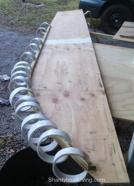

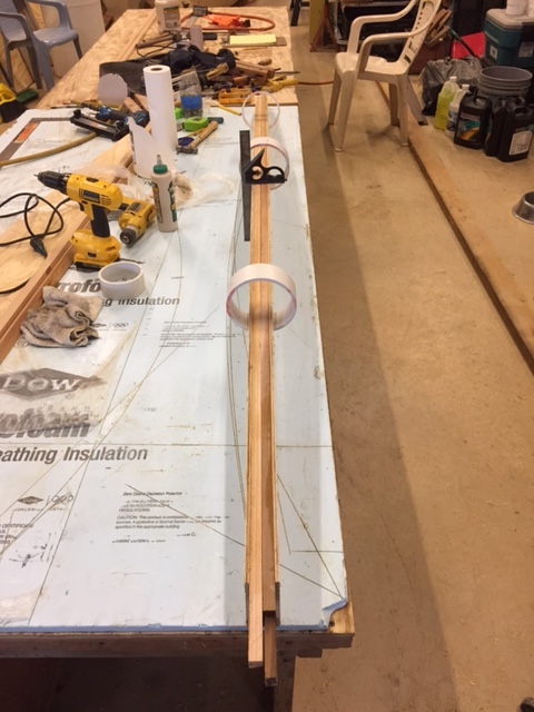

i found this idea some time ago and have been using it since
PVC clamps
depending on the type of work you are doing use from 2" - 4" PVC pipe cut in short lengths then slit down one side
for small boat building i use 3.5" - 4" diameter cut into about 3" lengths
the clamping strength is adequate for most glueing operations
when more pressure a second ring of PVC can be slip'd over the first

Swoody, that's a very neat idea. I just tried it... cutting a 2" OD piece of PVC I had lying in the shop. Way cheaper than buying store sold clamps. I suppose that method has its limitations as far as transferring strength, but in the right circumstances, very cool.
