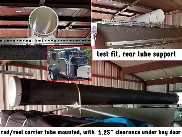

  • 8. 6"dia.x 98" long, roof-mounted locking storage tube (for fishing rods & reels)
    tube clearance.jpg (128.43 KiB) Viewed 1061 times

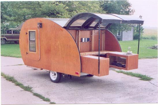

Galley slide outs, and the rack mounted awning. No more pop ups.
164545
Galley slide
