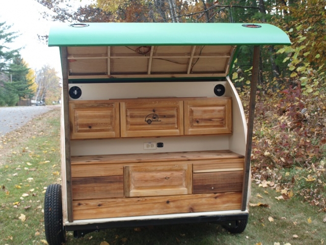

I glued up a 3/4" panel of cedar and oiled the hell out of it to keep water from penetrating. Cedar is soft and it has a few dents over the years but it is sure nice looking. I use a bamboo cutting board and really don't abuse the countertop much. I've oiled it maybe once since installing it.
A photo just after the galley was "finished" and before she was road worthy.

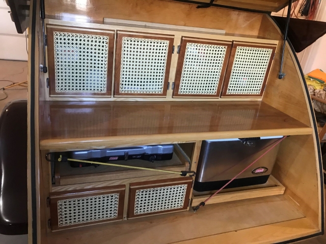

Thought I would post my solution. It will get another sanding and a final coat of clearcoat.
