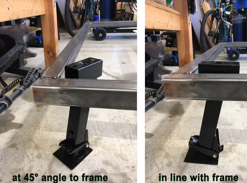

Regarding installation of the 2 stabilizer jacks at rear of chassis..... is there any benefit to orienting the jacks at a 45° angle to the chassis frame
or is it better to just mount them in line with the frame? Please see attached image for reference as to what I'm referring to.

I initially had them side to side, and had a lot of front to back sway. I went to 45 degrees and now its solid, I used the bal c jacks.

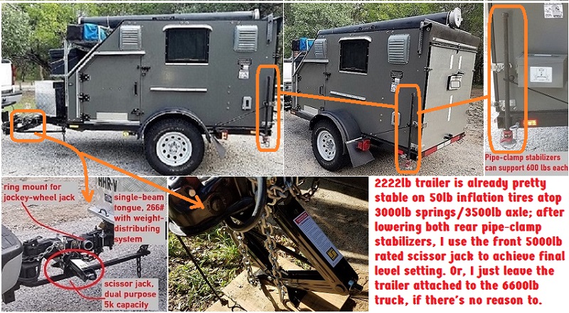

* I've never used the "Bal C" jacks personally, but have known those that do, usually angled at 45 degrees. My travel trailer (20ft Puma) has four scissor jacks, one at each corner, and it's very stable. My 4x8 squareback trailer is a one-off design (whatever works), with different stabilizer types and reasons for their use.
* Initially, I seldom used the rear pipe-clamp drop-down stabilizers at all, preferring to just leave the trailer hooked to the truck, no matter the angle. Then, I used them, along with the usual front tube jack (with sand foot) to level it better (though the tube jack allowed some wobble, being loosely ring-mounted on the tongue). My firm suspension really doesn't allow much movement at rest, so it wasn't a problem.
* Later on, I modified the tube-type tongue jack, adding an eight-inch jockey wheel, so I could roll it around (the tongue weight, at 260+ lbs, is a bit much for me to lift and tote). I added a 5000lb scissor jack on the tongue, so it now serves as a third point (discounting the tires) to anchor/level the trailer at the campsite (on my last trip, the wind was so strong, I actually wished I had anchored it down). If I don't plan to make any side-trips, I'll probably leave the trailer hooked to the truck, as there are always strong T-storms whenever I camp.

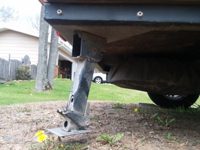

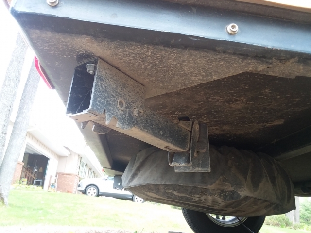

When I built Rose, I used the screw jacks at all 4 corners. Over time I quit using them in the rear, just in front to stabilize things with me in the cabin. Later I got tired of the th8ngs always being in the way so added Bal-C jacks, again on the front corners. Mine are mounted where I could find existing points to use. They’re about 20 degrees from perpendicular to the outside rails.

My experience, over the past 25 years and several trailers, is 45 degrees for best stability.

45 degree is best
Too much movement any other way

* Normally, on 2-3 day trips, I don't unhook from my truck, with enough supplies (especially ice) to last that length of time, and don't let down the rear stabilizers (hooked to the truck, they just barely touch the ground, and exert no lift or force to keep the already-stable trailer steady(er?).
* On some 3, and all 4 day trips, I do unhook, and dip the nose of the trailer before dropping my gravity-controlled stabilizers, then I raise the nose via the tongue's scissor jack, until the trailer is semi-level (I prefer a 5% rearward slope, to facilitate roof drainage, and to keep the onboard A/C at its' proper level). I'll need the truck available for side-trips, or food (ice) runs.
* There are always strong T-storms whenever I camp, no exception. My trailer is heavily-built enough to never move or shudder even in high winds (can't say the same about my canopy or porta-potty tent), but on my last trip, even with the trailer set firmly on the two stabilizers, scissor jack, and chocked on both wheels, there was a gust of wind about 1:30 one night, that moved my trailer just a little (and nearly wrecked my canopy and tent).
* My campsite was the most exposed on a point on a larger lake, unseasonably cold and windy (my site and a couple of others were called the "wind tunnel"), and every body stayed away. 100 yards away, underneath the trees, other campsites were much warmer and radically less windy. If I ever camp there again, I'll know to avoid the "wind tunnel", and if I can't, I'll leave my heavy trailer (2220+ lbs) hooked to my even heavier truck (7500+ lbs?).

Mine are inline with the frame.
Haven't had any problems with them staying put. Most people don't know how to use them properly.
