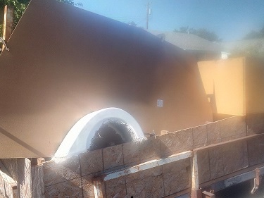

Postby saywhatthat » Thu Jul 01, 2021 1:26 am
Holy crackers . This thing is going to be so easy to build using these low-pressure a bunch of crap piled on top of it DIY foam core composite panels. no sparse .no floor joists this thing is so easy even if you put your shoes on the wrong feet you could do this.
Will pop the first wall tomorrow . under 4 hrs. to drill foam 8 sheets . 1'' by 8' x 4. cut all the fiberglass material for the both side walls cut the pattern and lay upped one wall. Jess and Scott and Jim for leading the way
So far the only thing I changed was the very bottom front I made it flat I didn't want to give up 12in of interior space.
The only one that seems ever been started is the one that Mike has in his basement
Now the only Hang-Ups are the size of the cabinets in the back.
Mike do you remember the size of the cabinets I know you drew this up 2012.
Do I put it on a Harbor Freight frame or for less cost do I make it four and a half feet wide. and use Angib lightweight frame we've been real happy with the rental units
nono templet.jpg (170.14 KiB) Viewed 430 times
