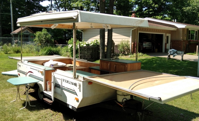

I just acquired a 1999 Viking pop up trailer. Actually, I don't have it yet. Its at my daughter's two hours away so I can't get more photos for a few days.
Wondering if you can tell from these photos what kind of axle I am getting. Is this torsion? It definitely looks like it lacks leaf springs.

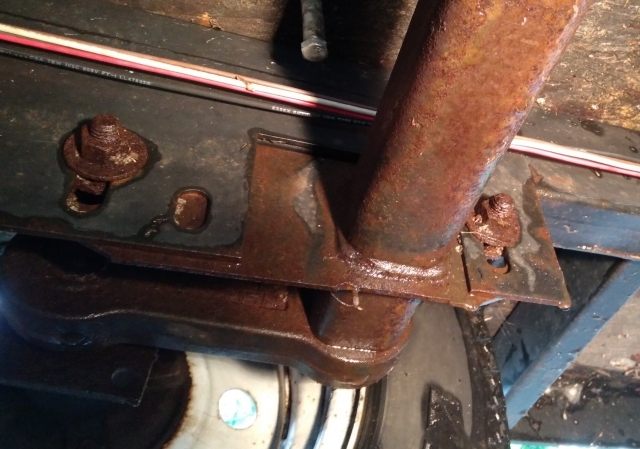

The parts you need to see are behind the wheel.
Definitely NOT a leaf spring system eg no leaf spring. It most likely is a torsional system. Could be a torsion bar axle -- the torsional components reside in an axle, typically a square tube. Most axle-less systems allow for a cross piece, typically a square tube, to help align and/or reinforce the system. Again, need to see what is behind the wheel.
The square tube looks bowed. This might be an issue.

Trailer axles typically have a bow in them to help compensate for the vertical load they bear and still have proper wheel camber. This way when the load is put on them the axle will flatten out and the wheels will be aligned properly.

If it has a trailing arm on the backside, it's a torsion axle. The bow in for camber.

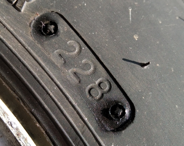

After inspecting the trailer it appears to me that this rig has seen very minimal mileage. How do I know? I found the tire date code and according to Mr. Google the three digit code changed to a four digit in year 2000. Prior to that the week and last digit of the year were all the information that can be found. I am going to assume that my tire's 228 code is 22nd week of 1998 seeing it is unlikely to be a 1988 tire on a 1999 model trailer. These tires "look" very new, however, I will be replacing them due to age. Actually I was very anxious the entire two hour trip home and took it very easy. Let's just say that these tires won't touch the street in front of the house much less highway speeds again.

I'd jack it up and see what the arm looks like relaxed and then loaded. If it "bottoms out" it needs replacing but I'll betcha it's fine.
